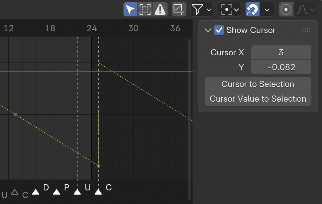

        #100163
        Grace Fandrich
          I don’t seem to have that option for some reason. The cyclic modifier is on. 4-27 at 11.40.20.png

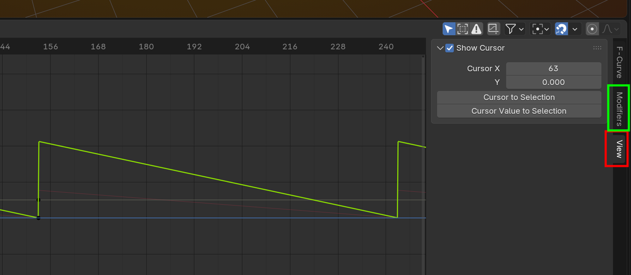

          #100164
            Hi Grace,
            I am not Wayne, but maybe that’s because you are in the  ‘View’, instead of the “Modifiers” Tab:
            #100165
            Grace Fandrich
              Thank you!
              I checked, but those options doesn’t pop up for me for some reason on the right.
              #100166
              Wayne Dixon
                Hi Grace,
                The curve needs to be active.  So you need to click it on the area on the left hand side so that Blender knows which curve is active.
                It can be a little confusing at times because a curve (or curves) can be selected but there might not be an active curve.  The last curve you select will be the active one.
                For example – if you select all the curves with `A`.  They will be selected but none will be active, because they were all selected at the same time so Blender doesn’t choose which one should be active.  This is by design (and it’s logical) but sometimes it can be confusing.
                Hope that helps.
                The good news is, you are probably an expert on active vs select curves now 🙂
