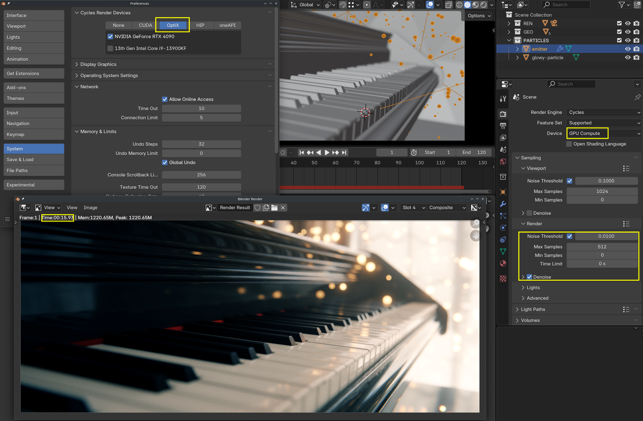

                  Follow up to this. My render time took 17 Hours. 🥴 . I have a Highend PC. each frame was about 7 mins per render. I have the samples at 1024 for the render. Is that too high for this type of render? Most of the other Macro renders took SIGNIFICANTLY less time than this Piano did. Is it something in the scene that causes the long render times? Thank you!
                  #88989
                    Hi Jason @jasonbadum ,
                    7 minutes is very long. Kent uses 512 Samples and Denoising (and he Renders at 50% Resolution). on my computer (RTX 4090) that took about 16 seconds for a Frame.
                    If I use 1024 Samples and 100% Resolution, it takes a bit less than 90 seconds, so that might be what you are using.
                    I’d suggest to try and stay under 2 minutes per frame, when Rendering an animation like this.

                         I also have a nice card for rendering (5070ti). Perhaps it is just the high resolution at 100%. I will see what the render time at 50% resolution instead of 100% is later this evening. I turned the samples down to 512, and it’s around 4.5 mins per frame.
