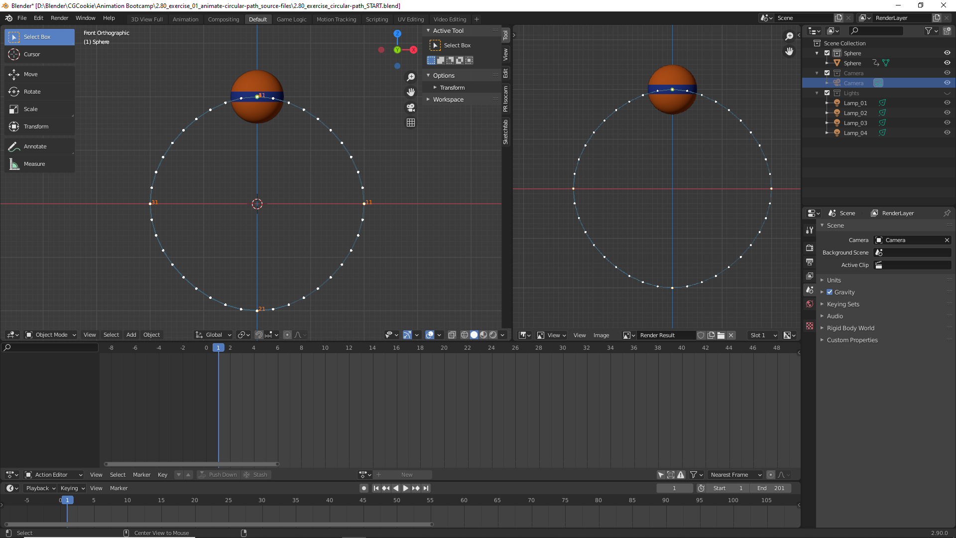

      I don’t have the keyframe number rendered with the motion path using the viewport render animation like most of the recent submissions but I noticed some olders has.
      Enabling the keyframe numbers from object/motion paths/display make it visible within the viewport using the camera view, so where is the magic toggle to enable it also when rendering the viewport animation?

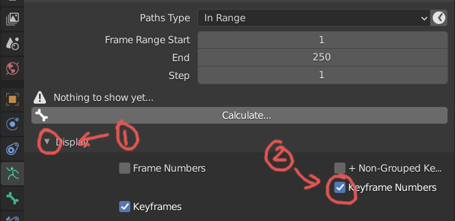

        Hi Franck.
        Just check you have keyframe numbers enabled in the little display toggle menu.
        Hope that helps.

          Unfortunately when I enable it via this display menu (in my case from the object properties as I don’t use an armature) it’s only visible in the viewport editor but not when using viewport rendering.
          Same thing happens if I don’t render from the camera view using viewport rendering:
          I know it doesn’t bother for this exercice I just wonder in case it could be for a future one.

          Wayne Dixon
            Ah yeah, I see.  They must have changed that.  I can’t recall if it was changed in 2.80 or later.
            But I know for sure you could see that numbers in 2.79
            It’s not a issue though, the main reason you need the numbers is for the animator in the viewport.
