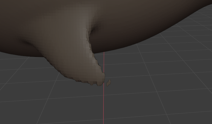

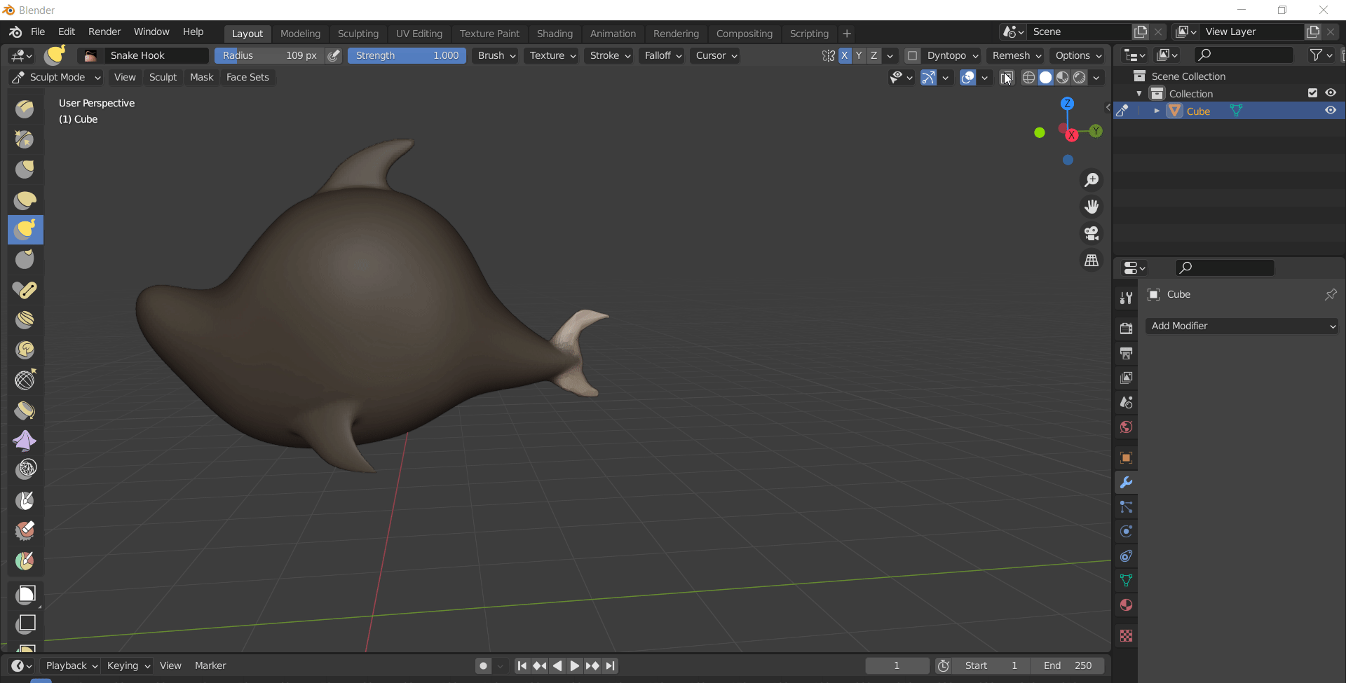

      When I remesh the mask for the tail it causes a the fins to separate a little.  Is there any way to fix this from happening?
      Closer image for reference.
      #64207
      ladymito
        Dyntopo on-> inflate -> smooth
        Or mask maybe?
        #64208
          You could try decreasing the voxel size in the remesh options. This will remesh with smaller polygons and should maintain thin corners like the fin better.
