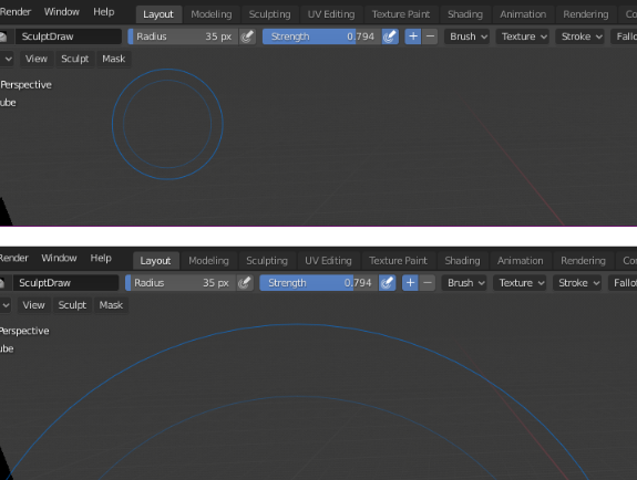

           To clarify, the actual brush size changes with the F shortcut, but the numerical radius slider in the header continues to display the same value.  Note how they both display 35 px in the image below despite the radius being changed drastically with F.

              Actually that screenshot is after the mouse button has been released.
              They do not change when the mouse button is released, the numerical slider value is locked until unified is disabled.
