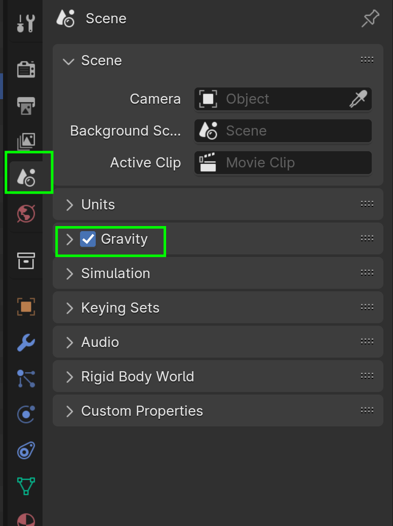

            #86638
              Hey James, you have turned off Gravity:

              James Treweek
                Brilliant! Except…at the same time, that’s REALLY f**** annoying.
                That’s a completely fresh scene so I didn’t turn anything off. That’s “out of the box” but whatever version I have on the laptop, it’s switched on by default.
                GRRRRRRR
                Thank you!!!!!

                    #86642
                      Hm, it really should be turned on by default…maybe you turned it off at one time and then the next Blender Version you installed adapted the old Settings.
