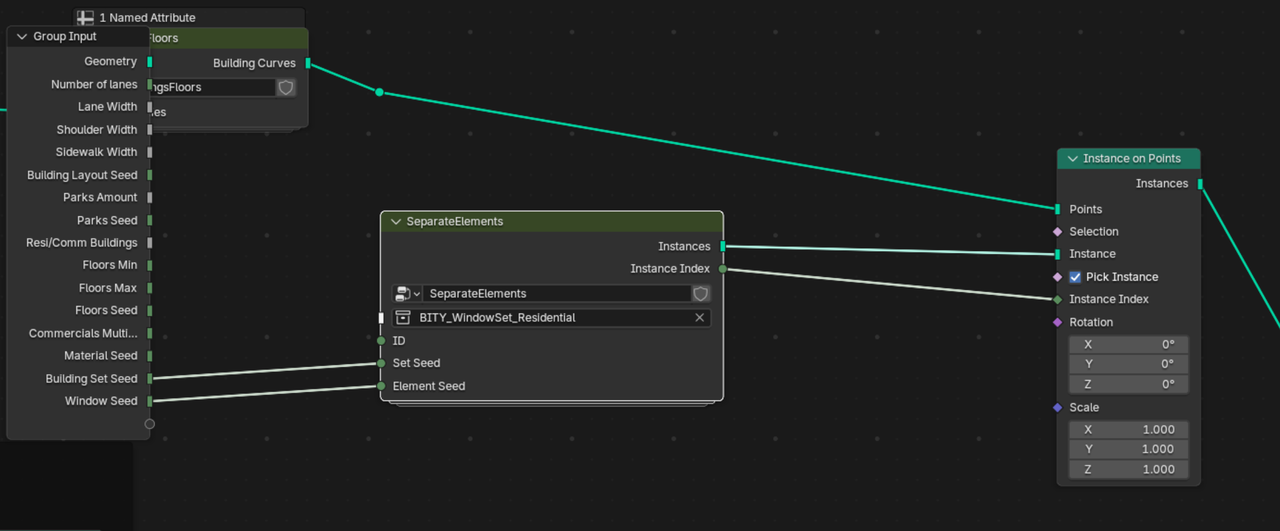

            Anyway, the problem why your ID isn’t working, is because there is nothing plugged into your ID:
            Not exactly sure where you are in the Course, but the ID comes from a For Each Element Node (this is from my .blend from the end of Chapter 5):
            Everything inside your SeperateElements Group looks correct to me.
