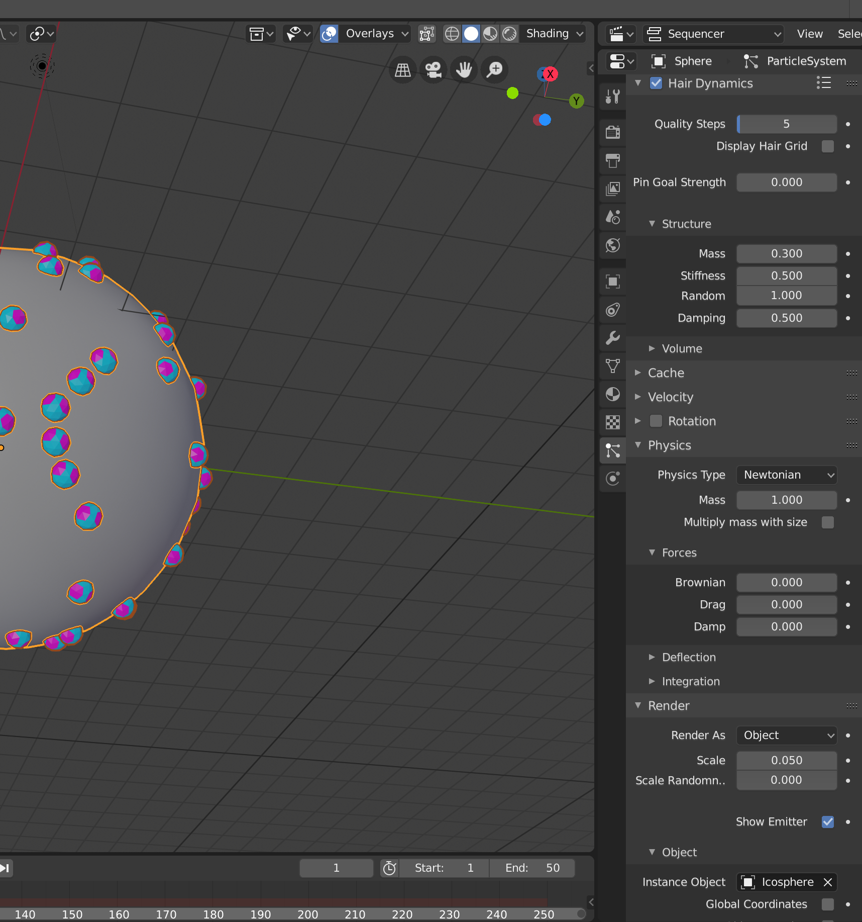

        tanya
          Did you try using hair particles? Set the render shape of the hair to the sphere and then play with the hair dynamics (mass, stiffness, randomness).  When I tried they rolled around, but were slightly imbedded in the larger sphere.  If you want to use plain particles check the gravity setting, I think the default is falling.

            tanya
              the above is with hair particles, I think you can’t or I don’t know how to key frame particles, but you can do a lot with force fields to control how they move and set things like initial velocity, etc.  I don’t know that much about them just played around some.  I don’t know if this is what you are after or not.

              tanya
                Here is a screen shot of the above particle system.
