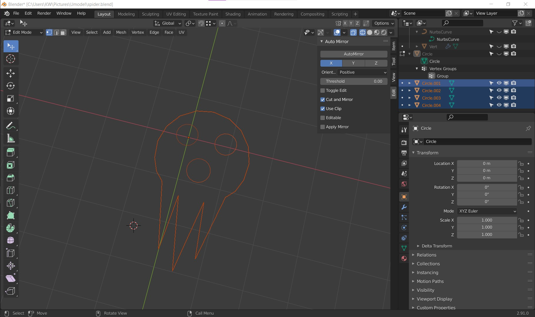

      Having a dumb moment and my brain wants to use Photoshop shortcuts desperately.
      Im just trying to make the eyes part of the mask. When I try to apply a face to the mask, it doesnt include the three circles and instead puts the face behind them.
      How do? is demb.
      #62671
      bitbuilder
        they are seperate objects circles .001-.004. You have to join them, CTRL+J into one object if you want to  extrude the whole, keep them the same if you want to cut out with a Boolean

          #62673
            Here’s a way:
            SHIFT+A > Add Curve > Bezier Circle:
            Set to 2D and Fill Both:
            Tab into Edit Mode and with all points selected, press SHIFT+D to duplicate the circle, S to Scale it down:
            W (RCS), or right-click next to  Curve Object (when using LCS) and Subdivide:
            3 times:
            V > Switch type of selected points to Vector:
            And simply move them in place, make a mouth when you want, by duplicating an eye:
            Look up modelling  with curves in Blender for more detailed tutorials.
