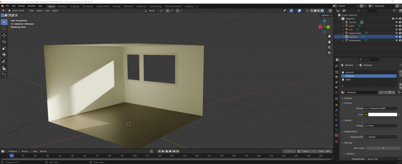

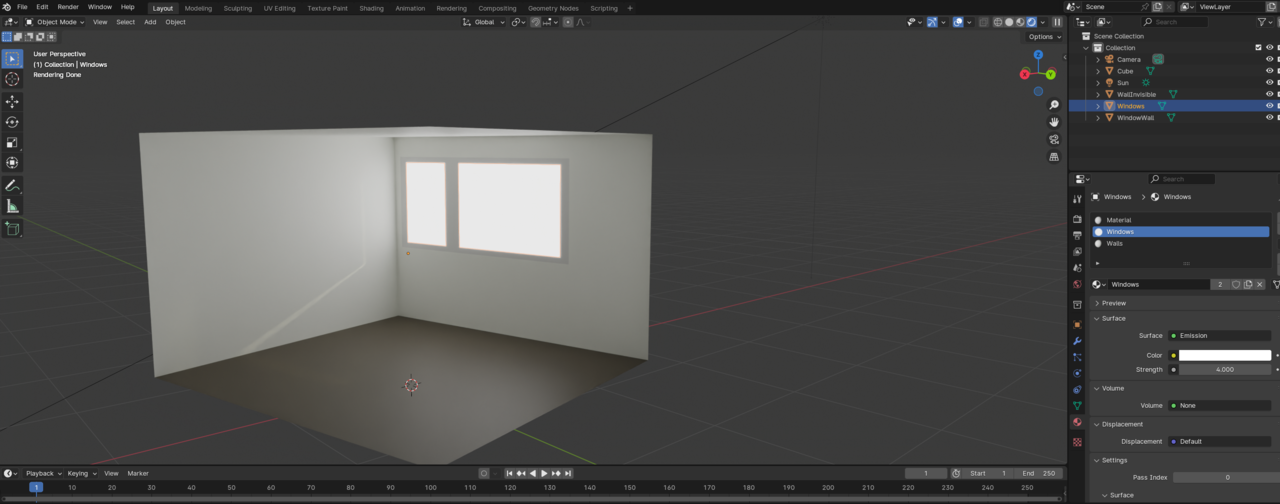

      Guys, I subscribed to your service to learn how to use Blender. I tried to recreate the room with just two windows. I tried using the emission material for the windows, but the problem is that the sun rays don’t pass through. If I change the material to transparent, it works. If I load your initial model, you used the same emission material, but it works for you. What am I doing wrong?
      Thanks 😉
      #86831
      Giuseppe Di Lisa

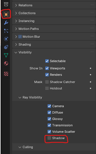

          That reason is that in the model that comes with the course files, the planes that are in the windows, they have “Shadows” unchecked in the objects properties. If you uncheck it for yours, it should work.
