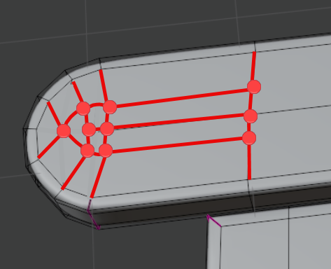

      So I made this 3d logo but I am not sure what the best practice is here. Is it a better idea to add a new loop cut at the top and let the middle loop cut bend? And of course I would appreciate some topology tips (like if sharpening the concave part like that is fine).
      I know this is super simple, but I don’t want to learn bad habits 🙂

      Grady Pruitt
        The main reason to bend the loop is if you were going to add some sort of detail along that route. Since the top part has 2 face loops and the side part has 3, If you’re not adding some sort of detail around there, you really don’t have to turn it unless you just want to.
        #97489
          As Grady says, you don’t need the extra polygons unless you have a good reason to. Usually it’s better to save on polygons, so if that is just a flat face where nothing is going on, the simpler the better.

          Charles

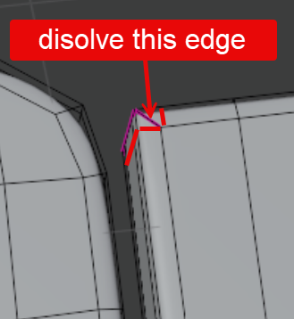

            As above – unless you need to model a detail you don’t need it. However it’s a good exercise to remodel this so you do get edge flow around your logo so you know how to do it when you NEED to do it – cos eventually you will need to do this sort of thing.
            Also – I think you’ve asked this – you can sharpen your right angles via topology (without using a crease) with cuts shown below then dissolve the purple edge on the top and bottom faces

              #97492
              Charles
                yes but it would sharpen the corner without a crease. That’s one of the other questions I’d thought he’d asked “And of course I would appreciate some topology tips (like if sharpening the concave part like that is fine). ” the grammar is a bit mangled so I’m not 100%. Sorry if I’ve misunderstood
