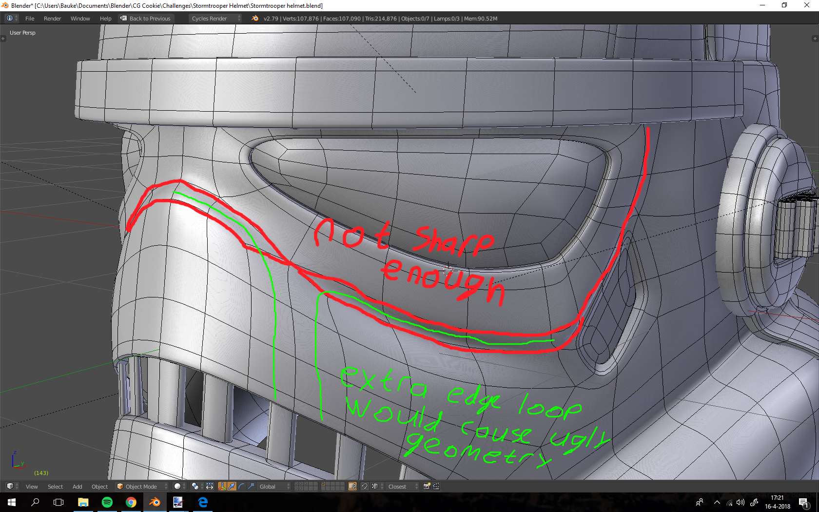

      Problem #1: these edges are too soft
      On a real stormtrooper helmet, under the eyes there’s a piece that goes outwards and one that goes inwards. However, I don’t know how to achieve this, while also creating nice and sharp edges, since adding a supporting edge loop would cause ugly and unnecessary geometry below it.

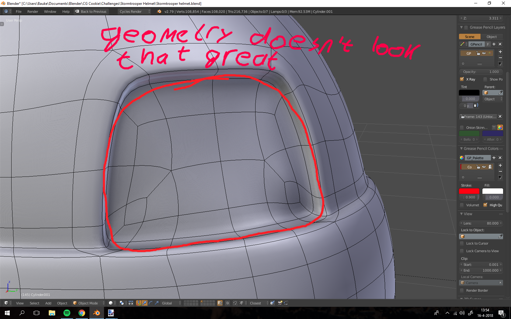

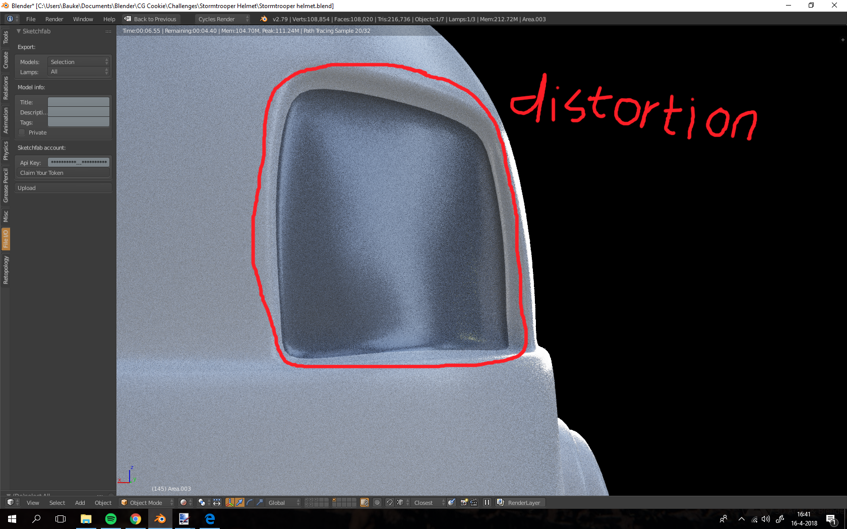

      Problem #2: these faces are distorted and don’t follow the overall rounded form

      #35012
      Ataru
        Hi,
        For your second point ( and also for the thrid one), I think you should maybe use a shirnkwarp modifier to avoid distortion. This tutorial may help you : https://www.youtube.com/watch?v=3rlMzsBWtPY . Not exactly the same problem, but you will see the power of this modifier :).
        Hope it will help you.
