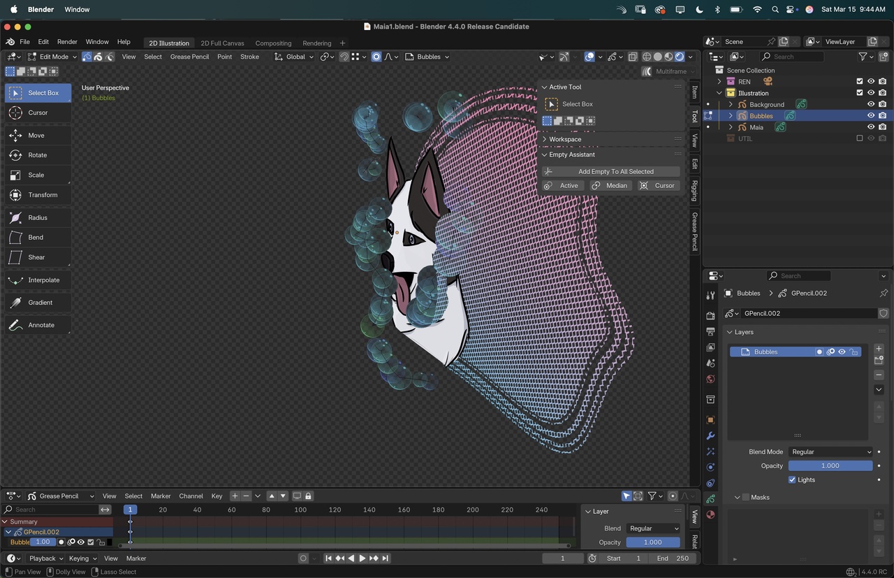

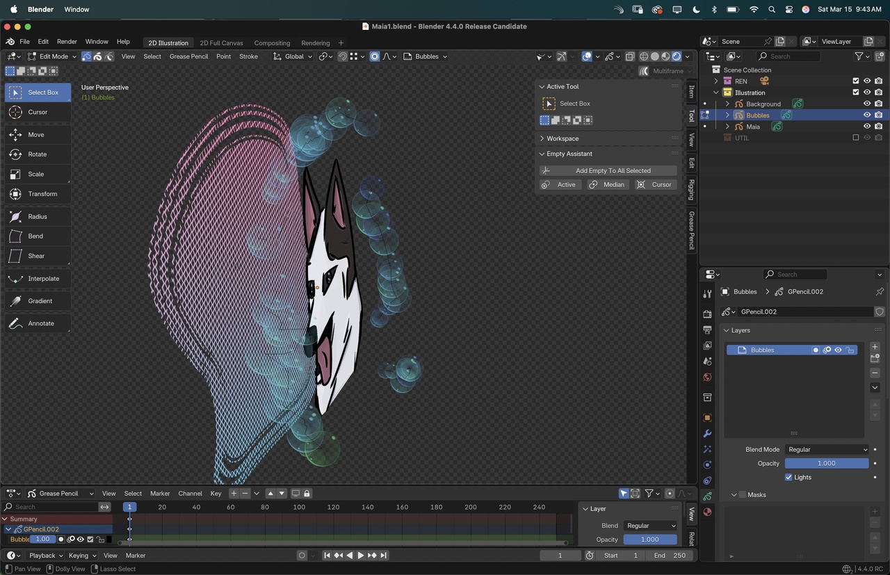

      I just love the bubble texture! So much fun! Particularly because I feel like no matter from where I turn, it feels like they really are little 3D bubbles, it’s almost like they are always looking at the camera, like a creepy portrait that freaks you out as you pass by, is that normal for all stroke textures?
      That is the only thing I can think of that is different to the pattern texture behind it… that texture is applied to the fill. And it does not have the same behavior or looking 3 dimensional or of “looking at you” as you orbit around.
      So that was the first question. The second question is, why is there at certain angles the bubbles will behave weird with the transparency and show the background, instead of the dog, but if I keep rotating they go back to normal? They do not intersect with the any other GP objects. 🤔

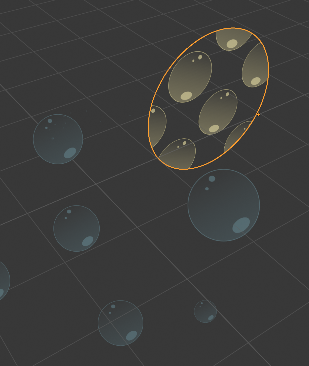

              The bubbles appear to face you because their texture is set to the stroke, so it is mapped on each point (dot/square texture) along the stroke. The texture applied to a shape is a fill, so it is mapped over the area.
              I used the bubble as a fill texture on the background object here, instead of on the stroke component of the Material, to demonstrate how they look different.
              #93842
              Paul Caggegi
                The reason the alpha is clipping the dog and not the background is likely because the Maia object shares the same origin location as the bubble object. It’s a quirk of Grease Pencil, that some aspects of the object will be calculated from the point of origin – even if the bubbles are spread out over 3D space. The way to fix this is REALLY simple – move the bubbles forward along the Y axis – even just a little bit – and the bubbles should behave.
                Note however, that if you wish bubbles that are positioned behind the monkey (in my case) it is recommended that you create a “background bubbles” object and position that behind the monkey.

                    Yes! Thanks for the detailed explanations Paul! Moving the origins worked like a charm!
