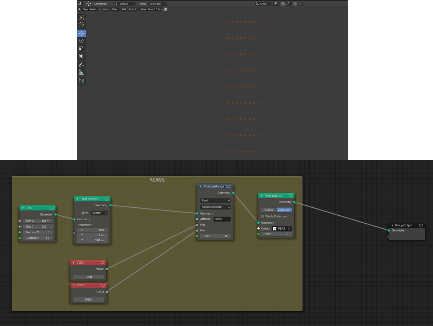

      Need some geometry nodes help!!
      I’m trying to place some items in a grid formation, but don’t want them too exact. I’m looking to add a very small amount of randomisation in the x and y directions, so the lines aren’t perfectly straight.
      I’ve currently got a set-up below using a grid input – is there a way of moving the individual points of a grid (I can only seem to move the whole grid)?
      Or should I set up each row as a line, and translate the point of each line?
      Or some other way??!!

        Ok, so I’ve found a solution, but it’s far from elegant. Basically, create a series of lines, and join them all up:
        Please let me know if you can think of a more efficient solution!

          Hi Tom.
          That is indeed not a very elegant solution;)
          I’d probably do something like this:
          So basically your first idea, but using a random Vector, not a float, to move in X- and Y direction independently and set it to Add and change the position Attrbute of the Grid points.
          #69287
          Tom
            Omg of course! So simple! Thank you so much – I had gone down a rabbit hole convincing myself I needed to to use “point” nodes, and finding each point’s xyz.
            Perfect, thank you!
