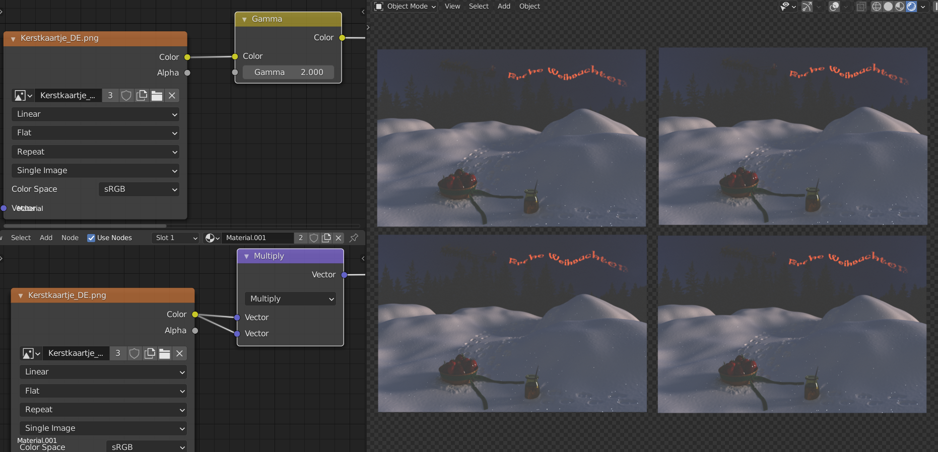

      @blanchsb that is probably what they use in Blender then, but it is just formula; there is no such thing as an absolute Gamma correction formula; ‘Gamma’ is a bloated word, meaning something like ‘to the power of’… a ‘Gamma’ of 1 (default in Blender Gamma Node!) would mean: raise to the power of 1, also known as: do nothing.
      Here’s an image squared twice and put through a Gamma Node, set to 2 another two times, can you tell which is which? (of course you can’t, because they are the same!):

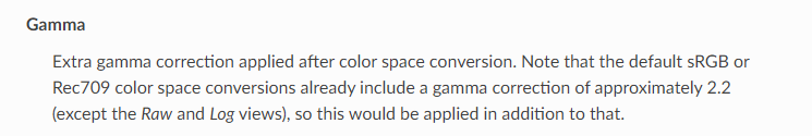

          @spikeyxxx Gamma correction varies based user selection in the Render Color management tab (default is set to sRGB correction). But the value is also dependent on what the color value is. In most cases with blender the internal gamma correction is somewhere along the lines of 2.2. That node in your picture is in addition to that internal color correction value for most workspaces in blender.
          From the older Blender 2.79 manual:
          The latest manual just states it is being done but the value of internal correction should still be the same.

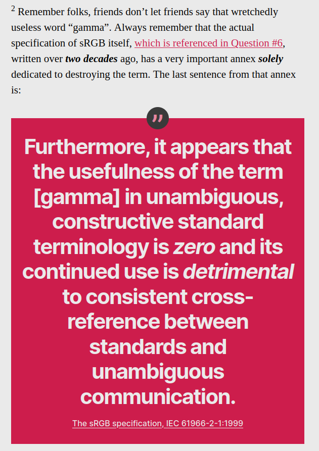

                @blanchsb you are riight, but I just wanted to say that Gamma is, in itself, a meaningless word:
