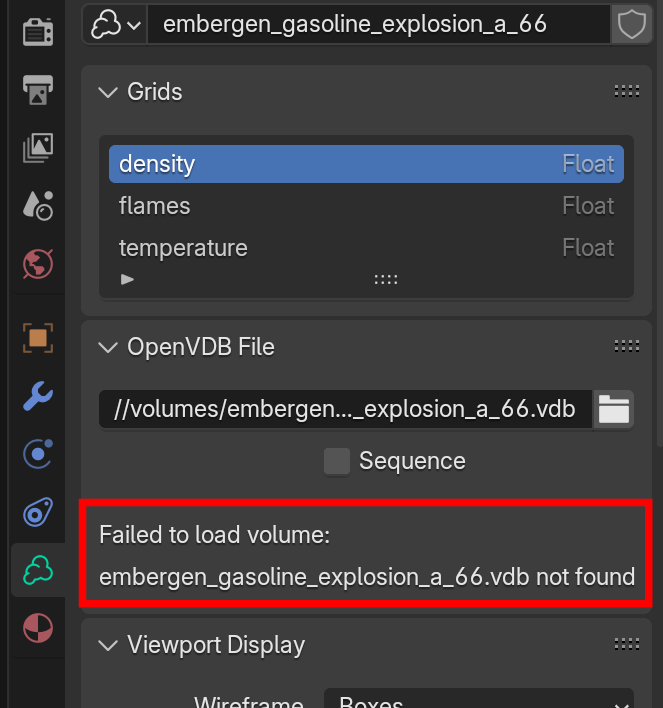

          Also, make sure that you don’t get a warning like this:

            Keswick Chow
              Thank you very much Martin and Omar,
              This is it!  I got the visual.  I have not used vdb before and did not realize there is a “Data” properties and that the vdb file have to be linked correctly there.  And the “File – ExternalData- Report Missing Files” did not show any problem!
