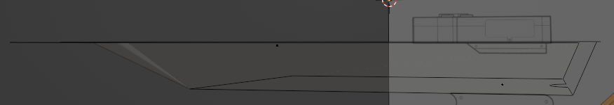

      Hello,
      On my side view, when I pull down to have the block shape the corners pull vertices and I lose the original shape.
      How could this be fixed?

        I’m also a beginner, if i understand right, you made a cut for a bottom block and didn’t extrude it, you are pulling down whole face that should stay, just try to extrude

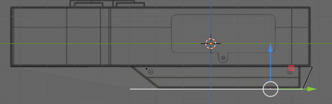

          @Sunn is exactly right, you need to use E to extrude, creating extra faces to form the shape.
          #81468
            So basically before you hit G to move, you first have to E to extrude then G to move.

              I Applied Extrude then just pulled it down and it worked.
