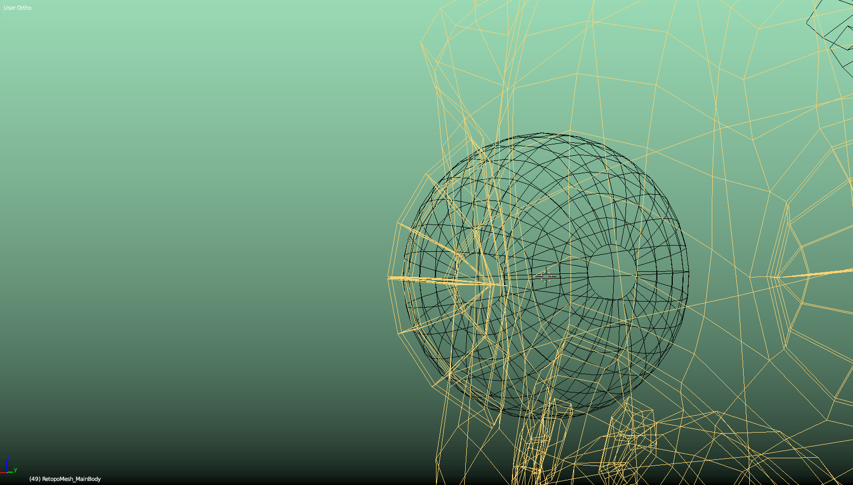

      @theluthier Your Piero’s eyelid line as seen in right side view points directly to the center of the eyeball which is good for a proper eyelid deformation. My eyeball center is a little bit higher so that I either have to slightly reshape my eyelid or reposition the eyeball.
      Another issue is when turning on the “Subsurf Modifier” because my Piero’s eyeball pierces through the eyelid when it is half opened. Without “Subsurf” turned on, there’s always enough distance between eyeball and eyelid.
