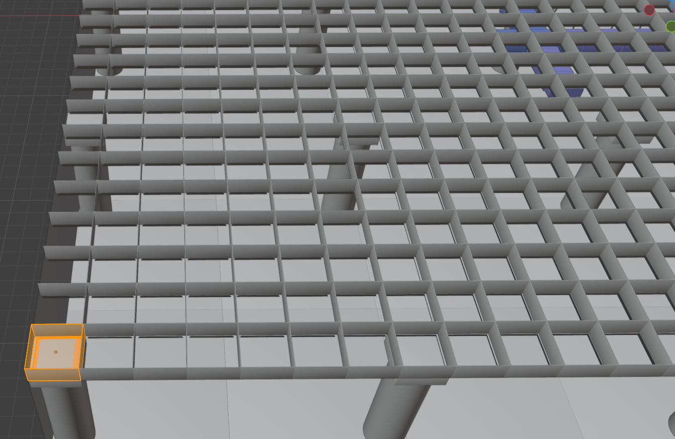

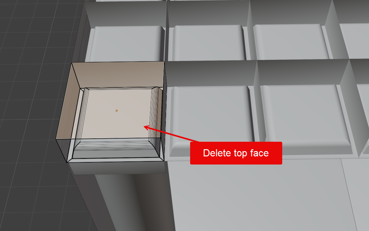

          I don’t know if this is an artefact based on a my modelling of the ceiling tile or a consequence of me using Blender 4.5 but If you are struggling with back face culling of the ceiling tiles… I found I needed to delete the top face first
          Then select all and reverse the normals which allows me to see through the ceiling in top view

              The tile I made didn’t allow me to simply flip the normals and see through it. I had to delete the top face before it worked. So I guess I’ve modelled the tile slightly differently. Maybe there was a step where this face was deleted or not created originally… I wasn’t following the video religiously. I didn’t know the exact reason so that’s why I caveated my reply
              #84611
                You’d need to Flip the Selected Face, not all Faces of the tile. At least that’s my guess as to why it didn’t work. Or there was more than 1 Face (overlapping or so)?
