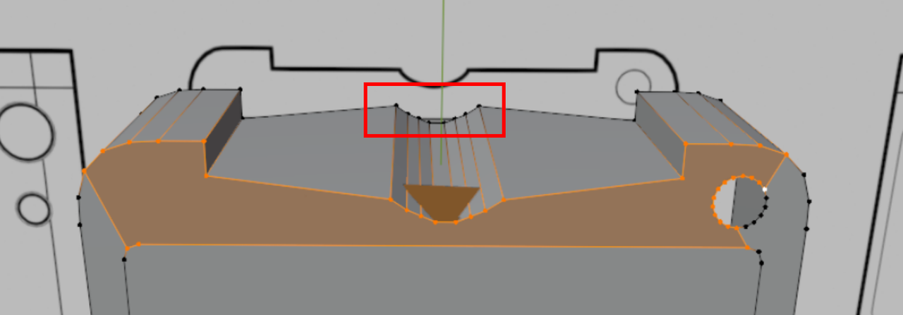

      Idk why a triangle type thing forms when I fill this last part can someone please help
      #100723
      Grady Pruitt
        not seeing verts attached to it, so my first guess would be a modifier is causing it.
        #100724
          Hi Hibah @Hibah ,
          there is also something at the back:
          I think that you had some extra, unwanted Vertices Selected when you tried that Fill.
          Delete the Selected Face, then, for good measure, Select all (with A) and M > Merge > By Distance. Immediately followed by SHIFT+N.
          Also make sure, that all Vertices that need to be Filled lie in one plane, because they don’t look like they do.
          Then Select the correct Vertices and triple-check that you don’t have any other Vertices Selected and press  F to Fill.
          Hope that helps.
