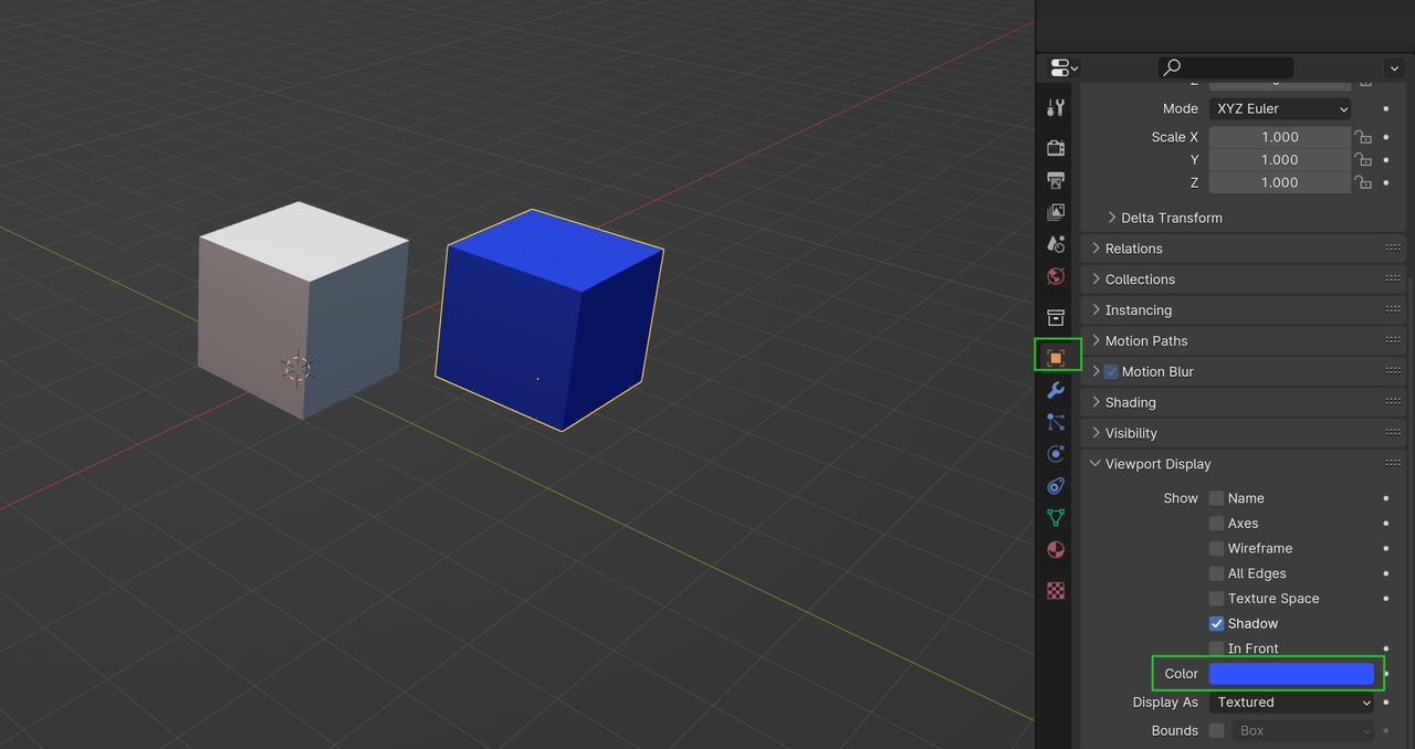

                  The random will put a random color overlay over your matcap, if you want finer control of the display color of your object you can set it to Material and assign a color to your material display
                  #83468
                    …and for completeness, you can also set it to Object, instead of Material and change the Object Viewport Display Color:
                    …so many options 😉
