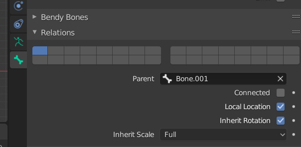

              Just so you know, you can also disconnect the child in the bone properties tab.
              Just uncheck connected in the relations tab.
