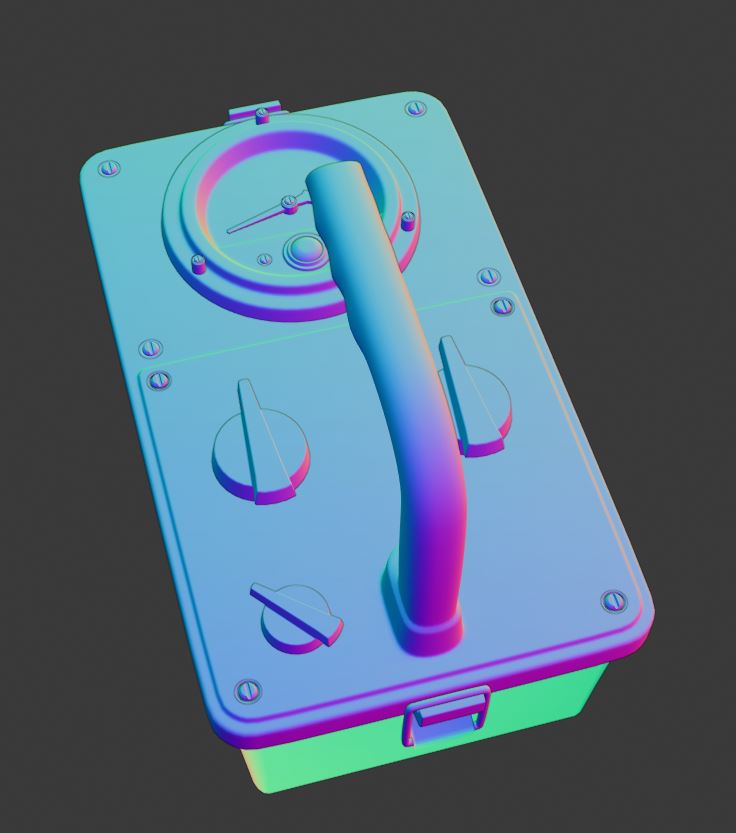

                  ppandoraspencil Hi Duncan. I appreciate your feedback, thank you very much. It will be easy to fix texture stretch and for the sofa i think i will sculpt some details.
                  Well, i was wrong. It requires more work than expected and after couple of trials to create low poly version from it i decided to go from the start once again. It will take much less time to build it again from ground up than to try to fix. Also i dont like the meter area.
                  Based on a new knowledge from creating gun for fps shooter which i watched couple times, i have now much better model with less geometry and ready for bake .
                  Here is a new version of dosimeter device with all the details. Please, let me know what you think.
                  #45123
                  Palo Piktor
                    New version of dosimeter lookdev.
                    #45124
                    malhomsi
                      @thepainter  hello ! u r going heavy with rust dust .. i have the impression that there is no more reflections !?
                      very good modeling and workflow btw
                      #45125
                      smurfmier1985
                        @thepainter definitely an improvement over the first one! The rust looks sweeeet 😃 As from what you’ve told about the game (dark underground facility, weird life forms) I think it will be a old and dirty facility right? Bit of an abanded / apocalypse feel to it? That’s the idea I had in my head when you told it, and this amount of rust fits that feel.
                        I do also notice, like Malhomsi, the dull reflections though. Your first model had more reflections on the paint an such, I think that would improve the look a lot.
                        Good job! Keep it up 😊
                        #45126
                        Palo Piktor
                          @malhomsi Thank you for feedback. I think i will have to better balance rust on some parts. Yeah good point, i will reduce roughness for metal parts.
                          @smurfmier1985  Miranda, thanks for the feedback. It should be really rusty, but @malhomsi is right. I forgot to bake higher res normals and downsize it to 2K. I had the feeling my UV layout needs improvement.
                          Here is a comparison of uv layout before and after. Bad news is, i will loose my textures so far and have to repaint them.
                           That empty space marked with arrow is occupied with a glass which is flat plane only and therefore i didnt bake normals for it.
                          #45127
                          smurfmier1985
                            @thepainter the new layout is much better, now you’re using all the texture space 🙂 good luck with the painting! good practise 😉
