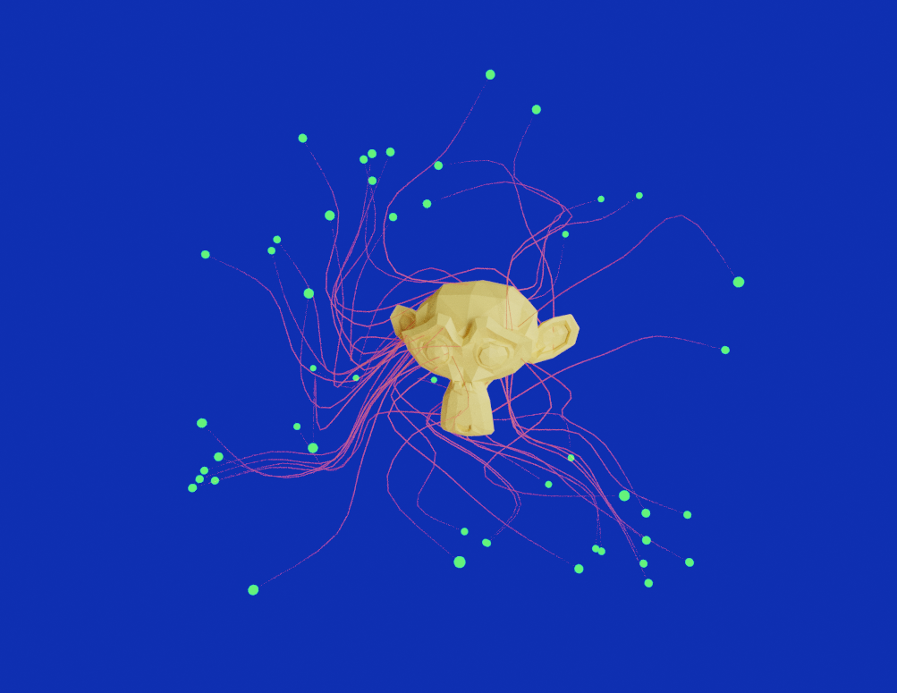

              #72387
                You don’t mean something like this, right?

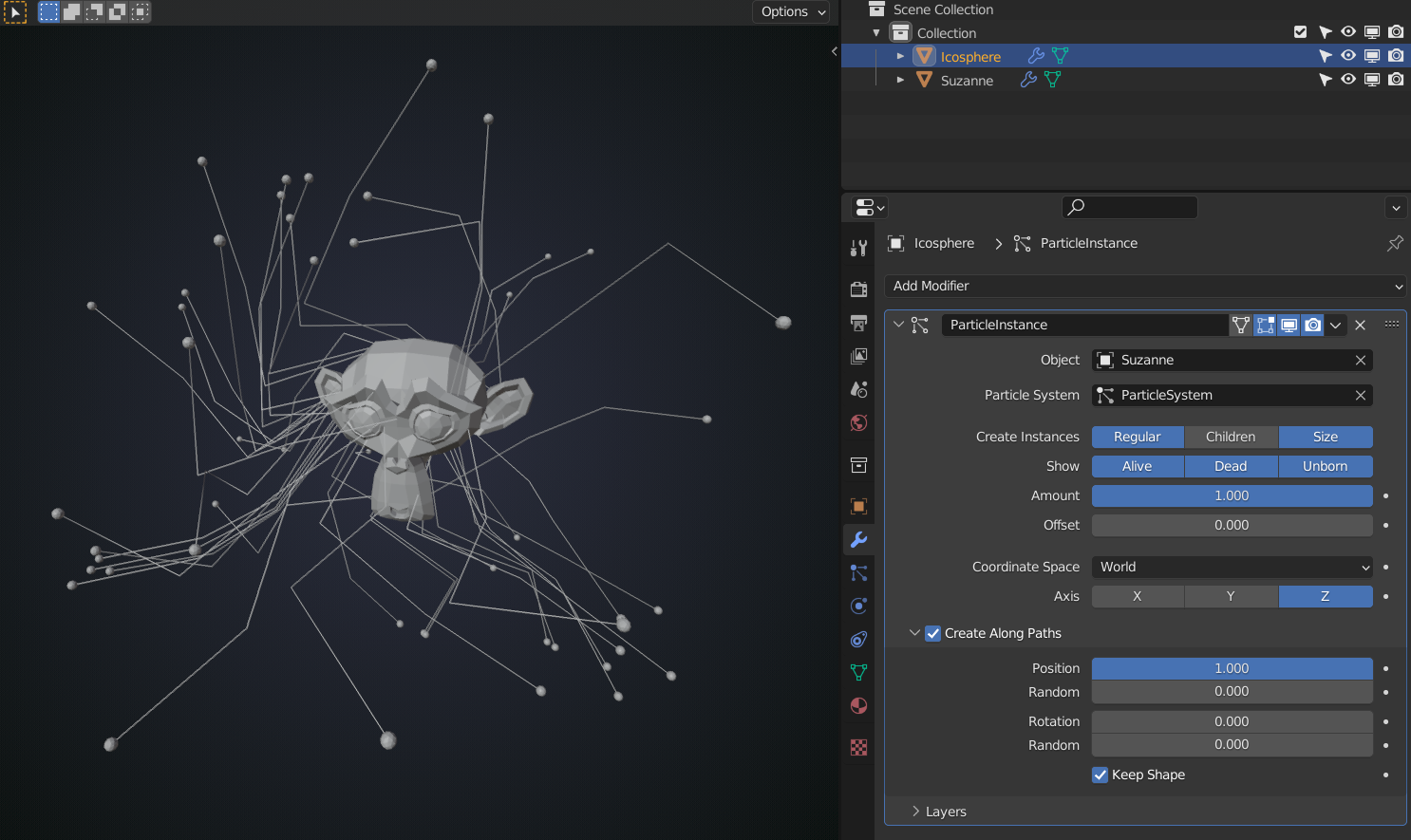

                      Not sure though how you managed to add a sphere at the end of each hair
                      I used a Particle Instance Modifier on an Icosphere:
                      The fun thing is, that when you add physics to the hair, then the Spheres (or leaves, in your case) follow along.

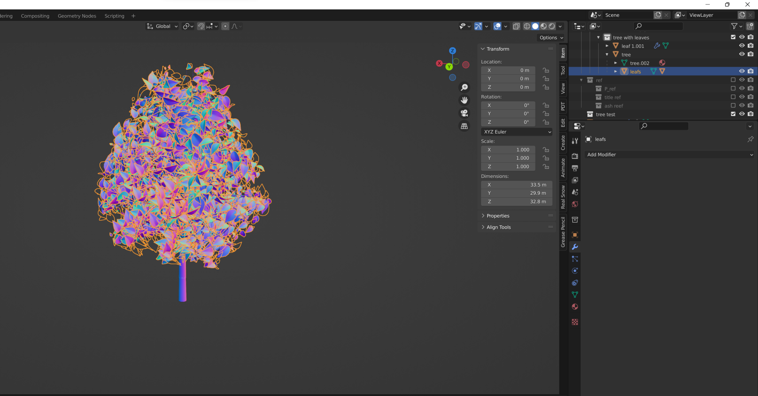

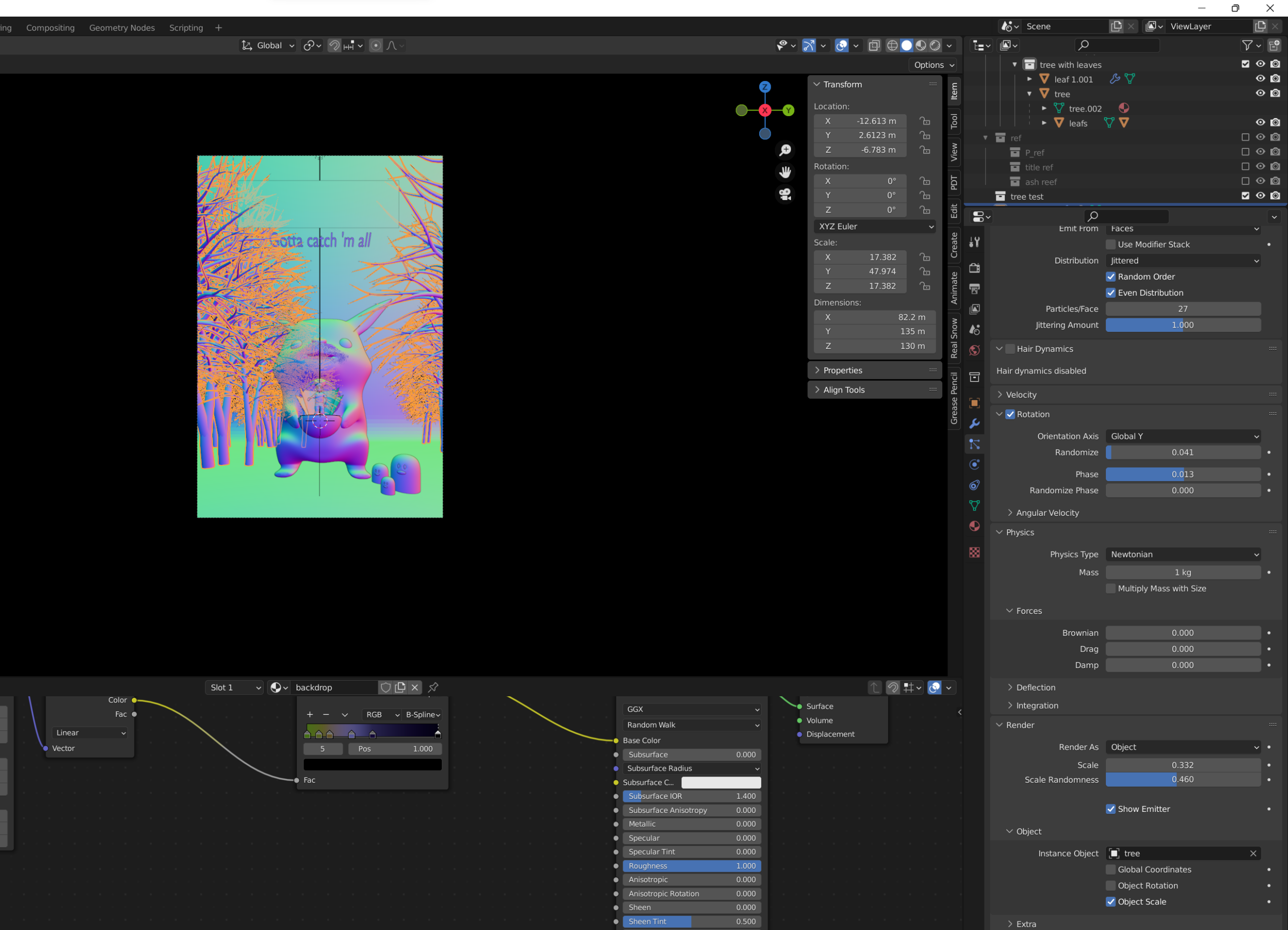

                        Hi @spikeyxxx
                        I tried with the instace modifier and could not get it to work. I suppose there is something wrong with the workflow I chose.
                        So using the sapling tree I create a tree base and add within the plugin leafs (based on a own leaf design)
                        The leafs are parented to the tree
                        When I select the tree in the particle system, it’s only taking into account the trunk and not the child leafs
                        using the instance modifier gets me the same results.

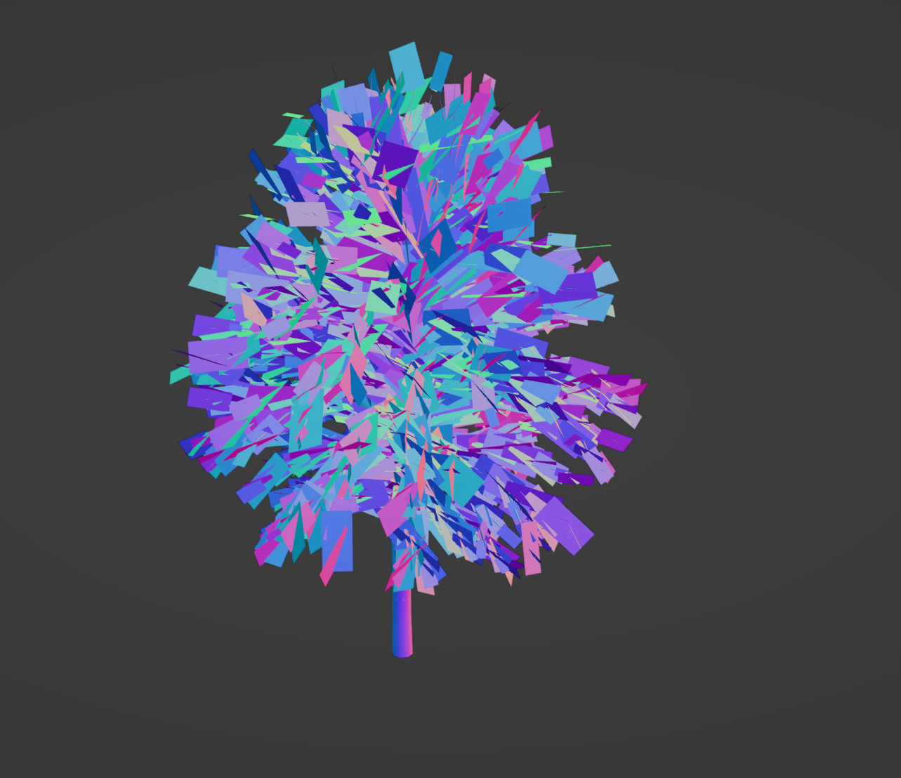

                        When I try to join both leafs and treetrunk, it not only joins the leaf object to the trunk, but mixes it with the instancer:
                        So I guess my question is, is there a way to achieve this with two objects that are parented to each other, or do you need to work using nested particle systems -> particle system of leafs to tree trunk and a second particle system of the tree trunk to the ground plane?

                          Oh, I see…
                          You mean something like this:
                          I think what you want should be possible, but I don’t know (yet) how to do that (with the Particle System…should be doable with Geometry Nodes).
                          But you can CTRL+J the leaves to the trea, making it one Object, like I did in the example above.

                            Hey yes exactly, except I can’t seem to remove the instances of the leaf elements.  When I press ctrl j, the leaf and the instance element merges and creates a rectangular leaf.  I can hide the instance, not delete it.  This instance is created by the sapling tree plugin

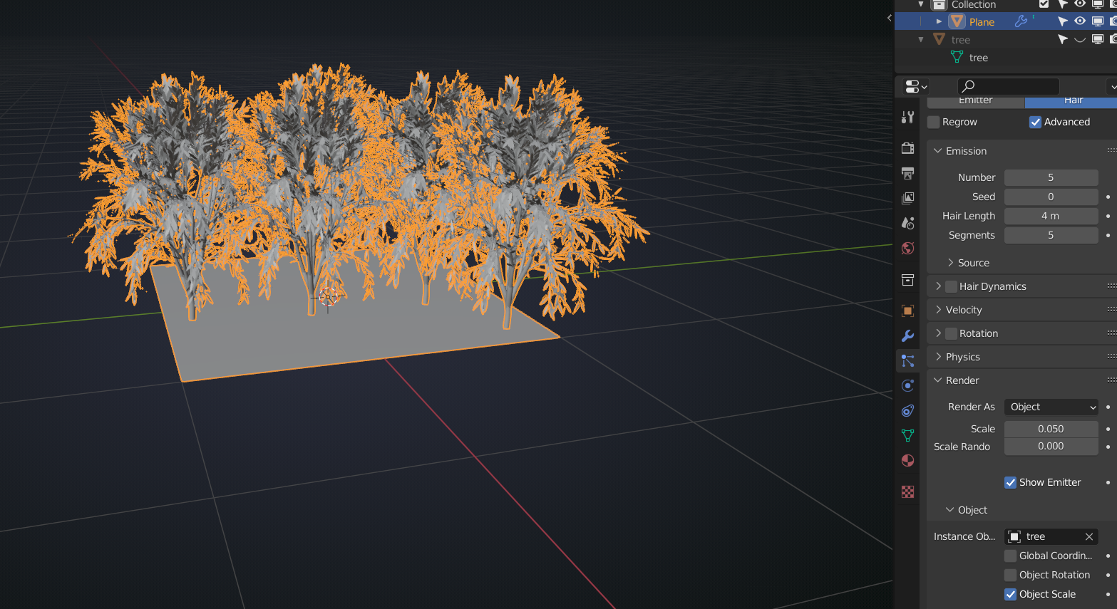

                              Okay, I found somethingThanks to Chris P. : https://www.youtube.com/watch?v=UpvNJvsq-FU
                              The Ground gets a Particle System to spawn the trees, but set the Render to None:
                              Not sure if this also works with Hair, but this should do the trick.
                              Then make a Particle Instance on the Tree, which makes the Trees Meshes that can emit other Particles:
                              and add a Particle System after that, making sure to tickUse Modifier Stack:
