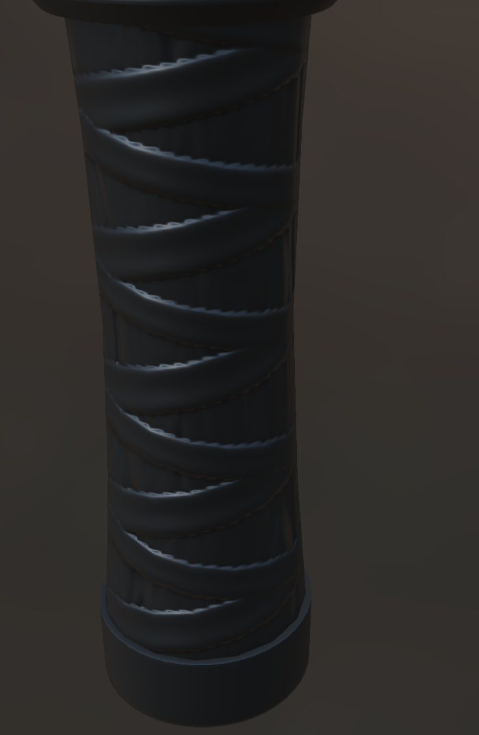

      Having an issue with the hilt being too pixelated around the edges. I’ve tried a few things and can’t seem to fix it. Any guidance would be appreciated.

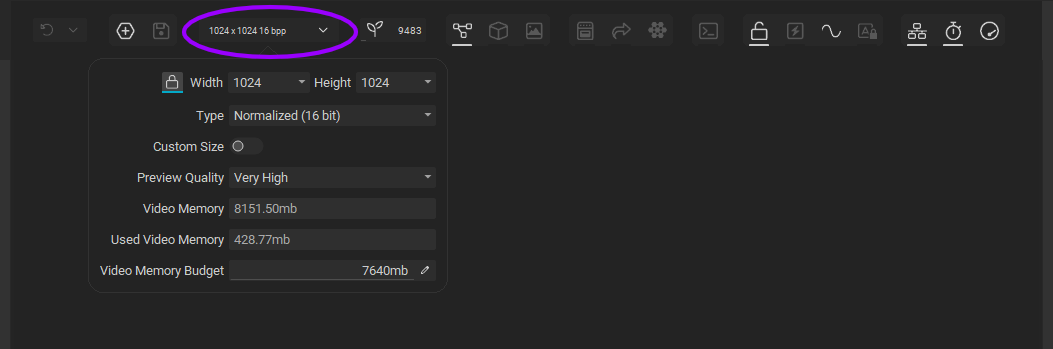

          Thanks for the help! I tried making the uv island a little bigger and that helped a little but you could still see the pixelation from almost any distance. Then I noticed there was a quality setting in instamat for the viewport I upped it to 2k and that fixed the issue completely.

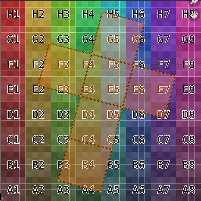

            I’d like to add that this is sometimes cause by angling of the UV map. Basically the edges of the UV map goes in an angle instead of straight up/down or left/right. This causes the edges to create an anti-aliasing effect on the faces of the mesh. Increasing size of island and resolution of image makes this smaller.025-02-09 102724.png
            Sometimes that won’t be enough and you will need to go back and redo the UV map and make the edges more straight. Especially with Normal maps.

              Where did you find the quality setting for the viewport? I have the same problem with a pixelated hilt and maybe that would fix it but I cant find the settings for the viewport ^^
              #93093
              Adrian Bellworthy
                @Lisa-Marie Kugler the quality setting @interstellar mentions is in the Instamat viewport. I guess referring to the popup on the top menu bar.
                How close you zoom in to the model will likely make a difference to the setting you choose.
