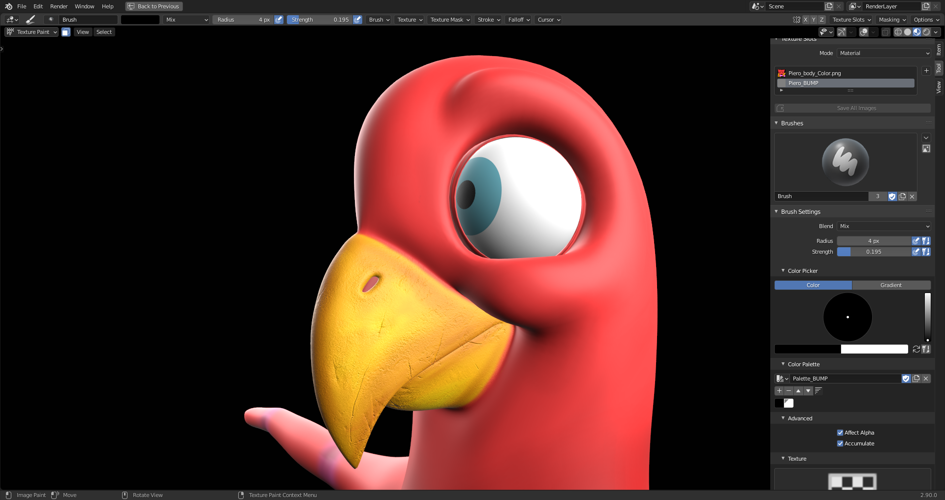

      The cracks were mainly created with rotating and scaling a “Grime Texture” in “Stencil Mode” of the “Texture Brush” used.

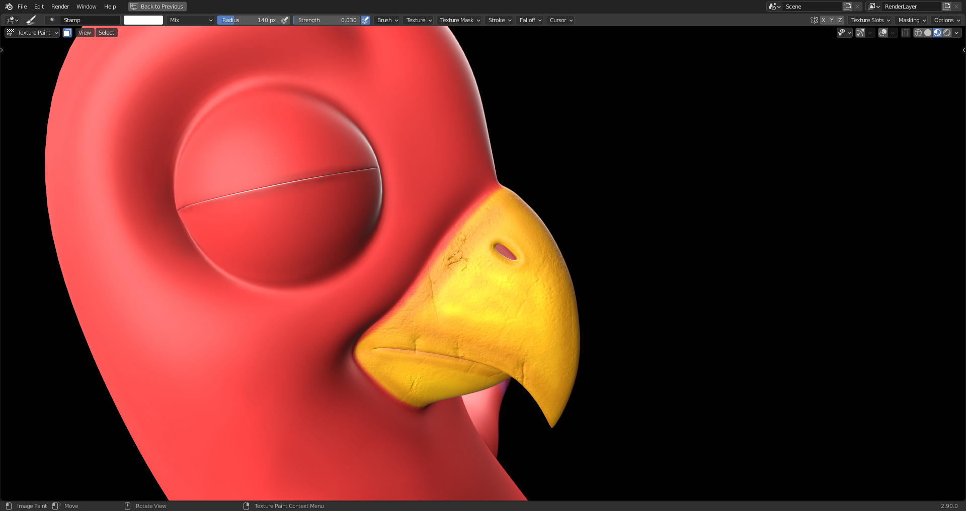

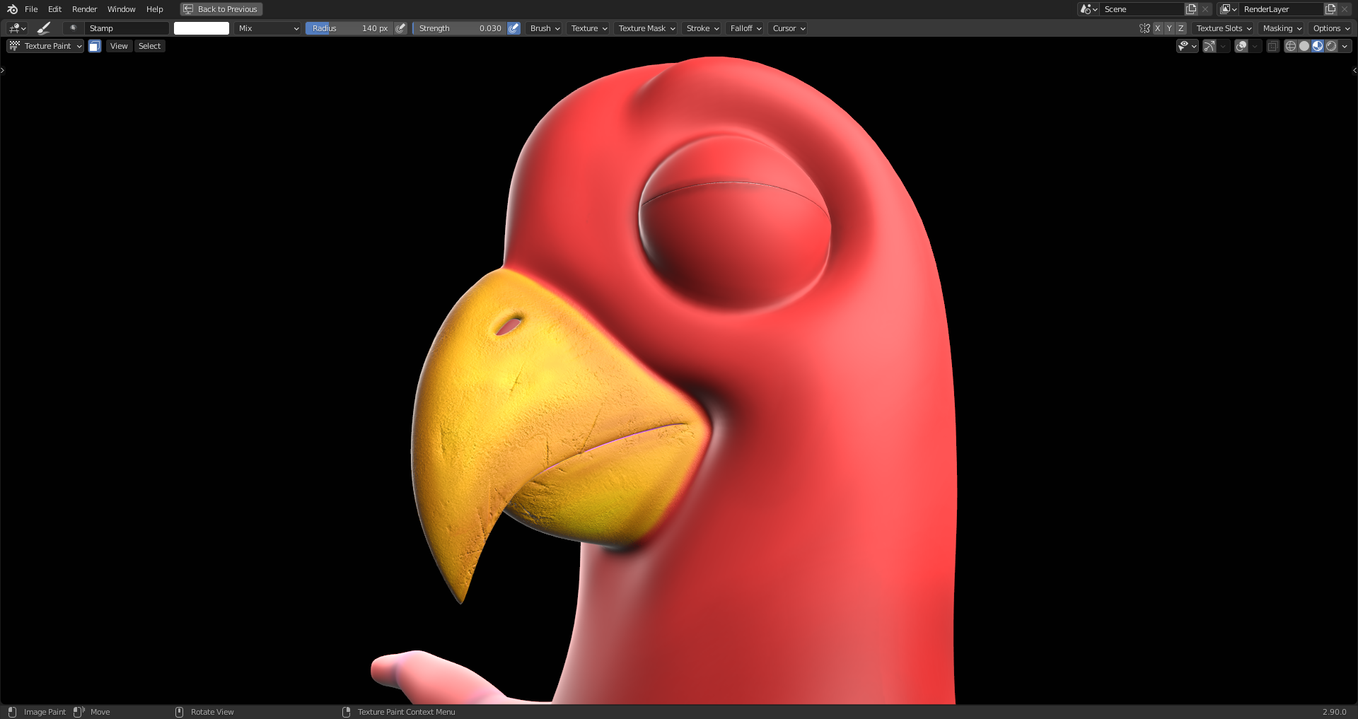

        Some manual cracks added using a tablet and “Pressure Sensitivity” turned on:

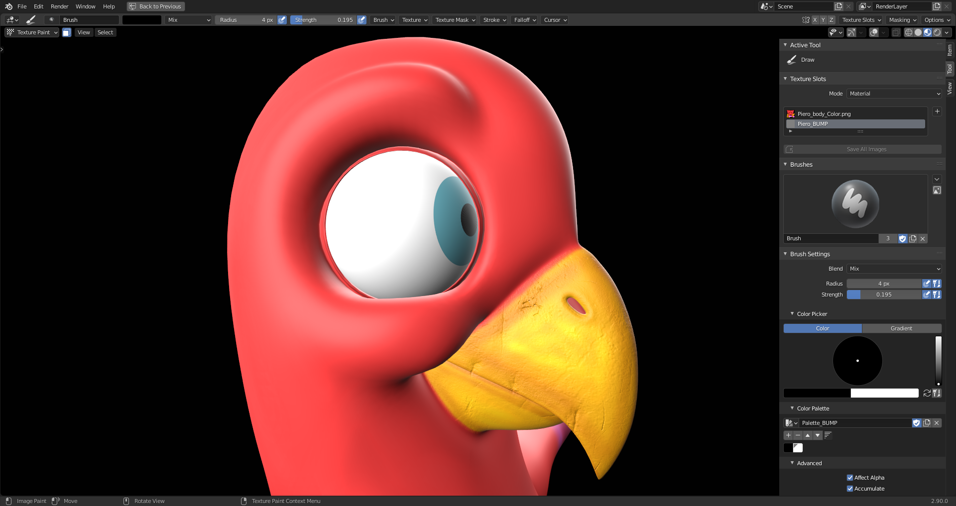

          The claws with the hand-painted large scales using again the tablet (which I’m not yet very familiar with 😉) and “Pressure Sensitivity” for the radius and the strength of the brush:
          As I’ve learned, the “Pressure Sensitivity” is a percent value of the setting that you entered manually into the field where you can use that dynamic feature. So, setting a value to zero means that you won’t have any effect with your tablet pen no matter how strong your pressure is. When creating Piero’s large claw scales, I used “Radius” = 74 pixels   and   “Strength” = 0.112.

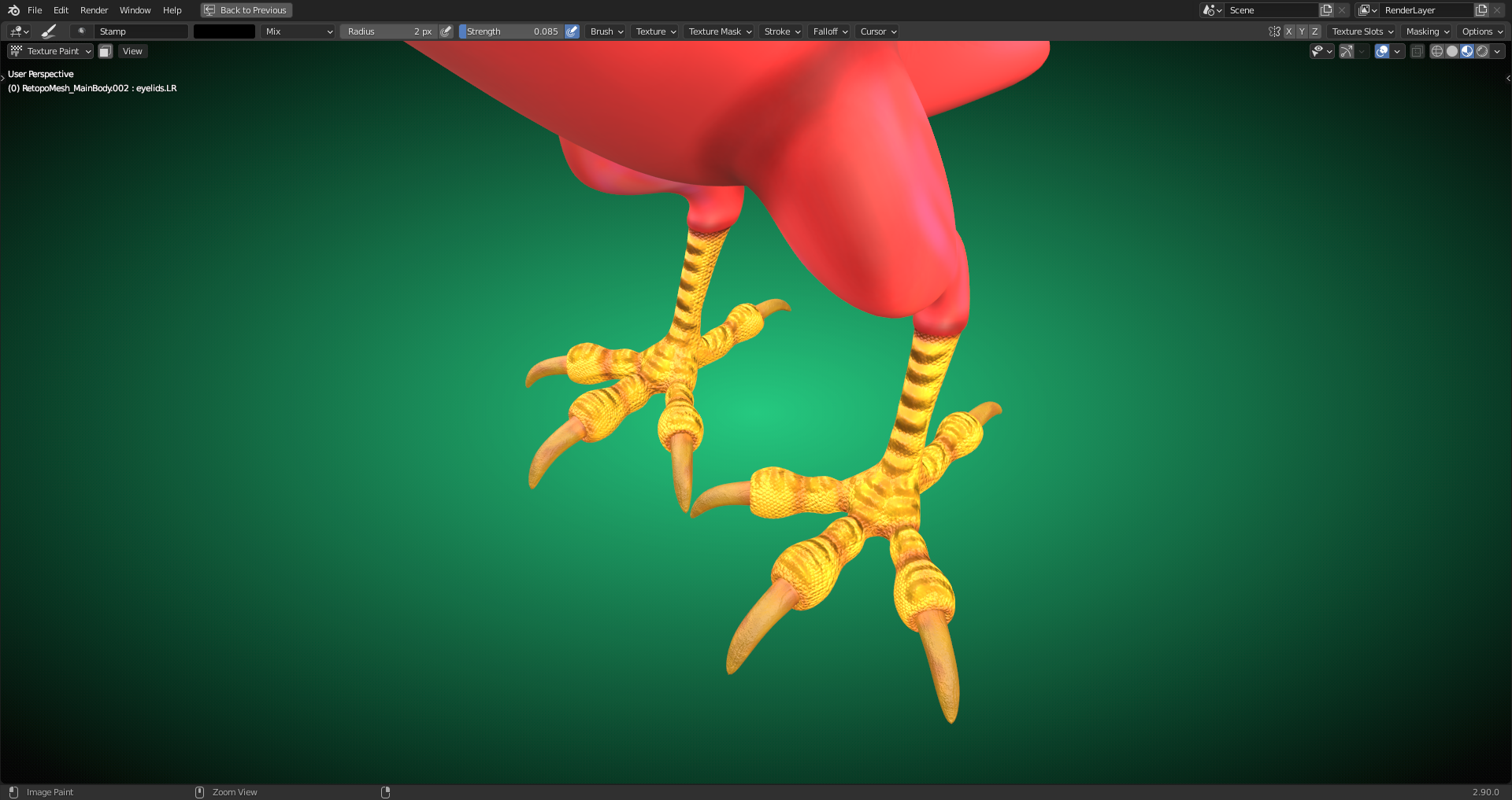

              Ingmar Franz

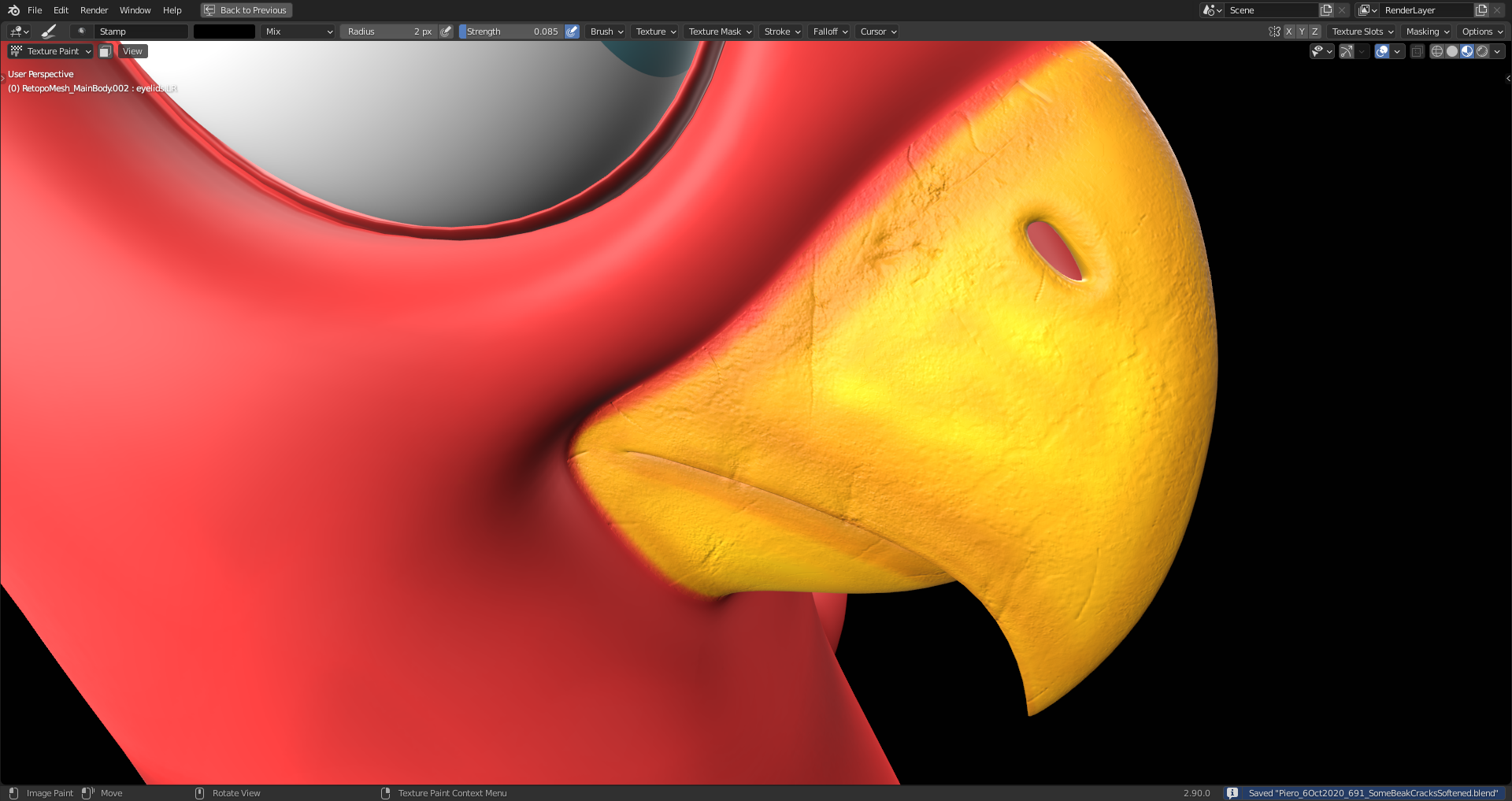

                The “Bump Texture” is now complete with the talons now having a more uneven looking surface that shows some cracks:
                I’ve also softened some beak cracks:
                Next and final step of the texture painting will be to blend the “Bump Texture’s” shades of grey into the “Color Texture” in order to make them look “more connected”. This will be done in Gimp using “Overlay” as “Blend Mode” and blending in selected parts of the “Bump Texture” repeatedly.

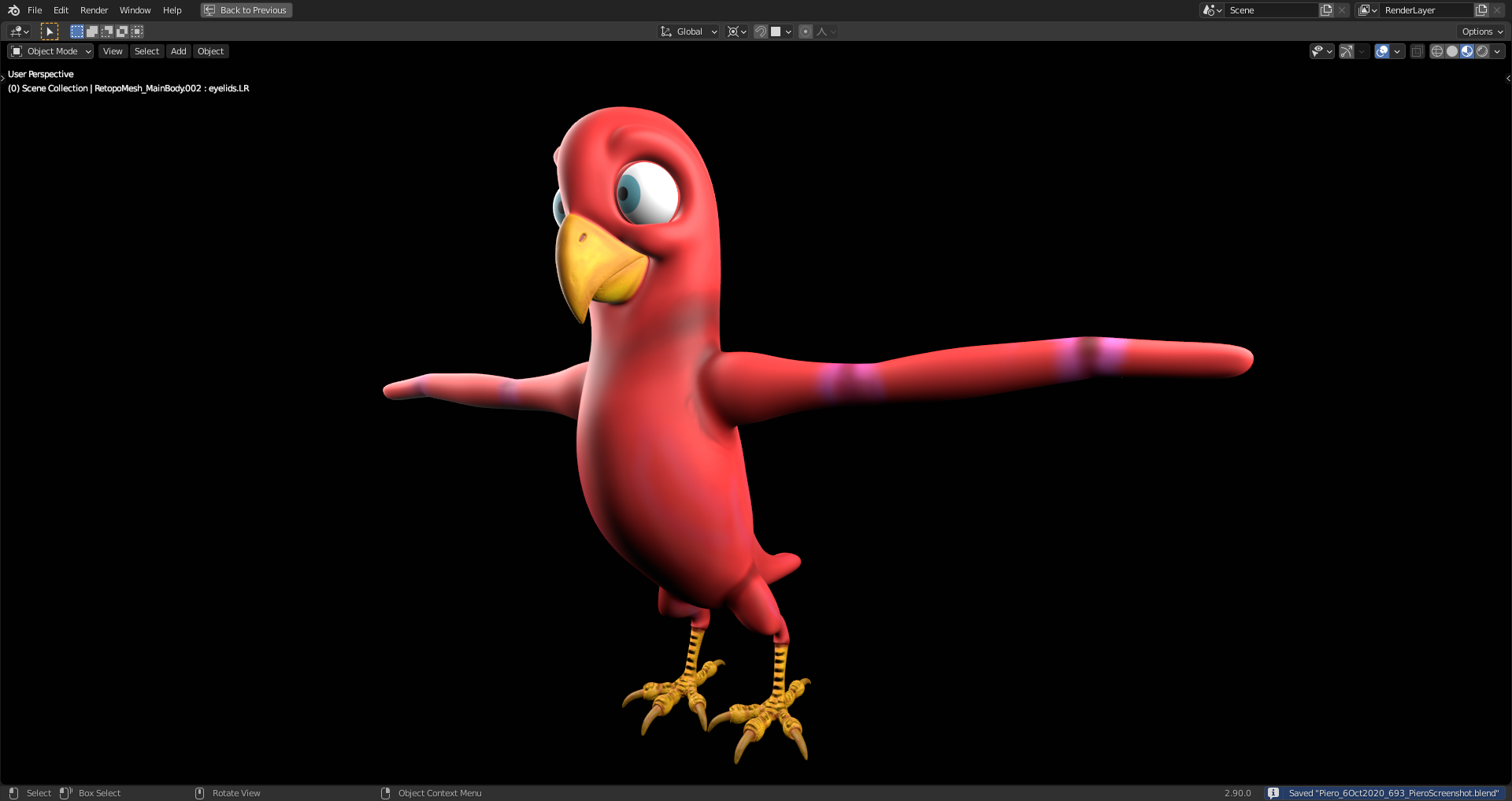

                  With that texture applied, Piero looks like this:
                  In order to use this texture on your model, you have to select it in the image texture node:

                    #60628
                      This is looking great! I prefer your lighting to mine honestly. My only advice is to try dialing down the feet bump by about half. In the latest image it looks too strong to me, giving itself away as fake geometric detail.
