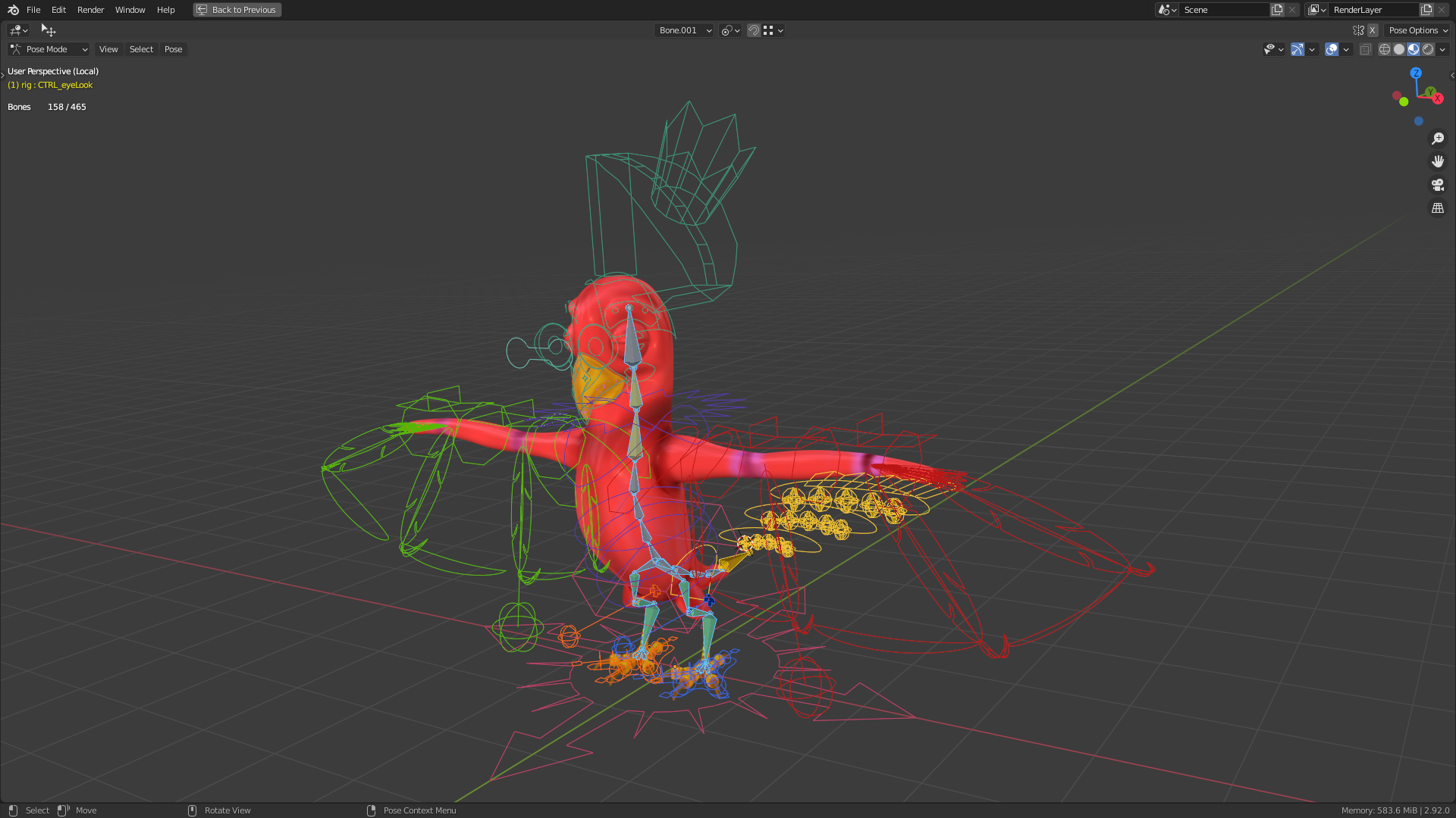

      After cleaning up the rig and creating “Bone Groups” as well as some missing “Custom Bone Shapes”:
      Next step: Creating face expressions for the “Pose Library”.

        Look at the plumage! Those custom bone shapes took a little while to make. Wow! A literal crown shape to control the crest. Very nice! The root bone has become a compass. You have been busy.
        #68897
        Ingmar Franz
          Thank you, @ullreym ๐Ÿ˜€! I had created most of the custom bone shapes already last year. Now, I’ve added some new ones after seeing in Kent’s “Animation Preparation” video that he had added more custom bone shapes at the wings as well as at the tail. Creating the facial expressions for the “Pose Library” will certainly take a while since I’m not yet that experienced as Kent was already when he recorded the “Piero” course.

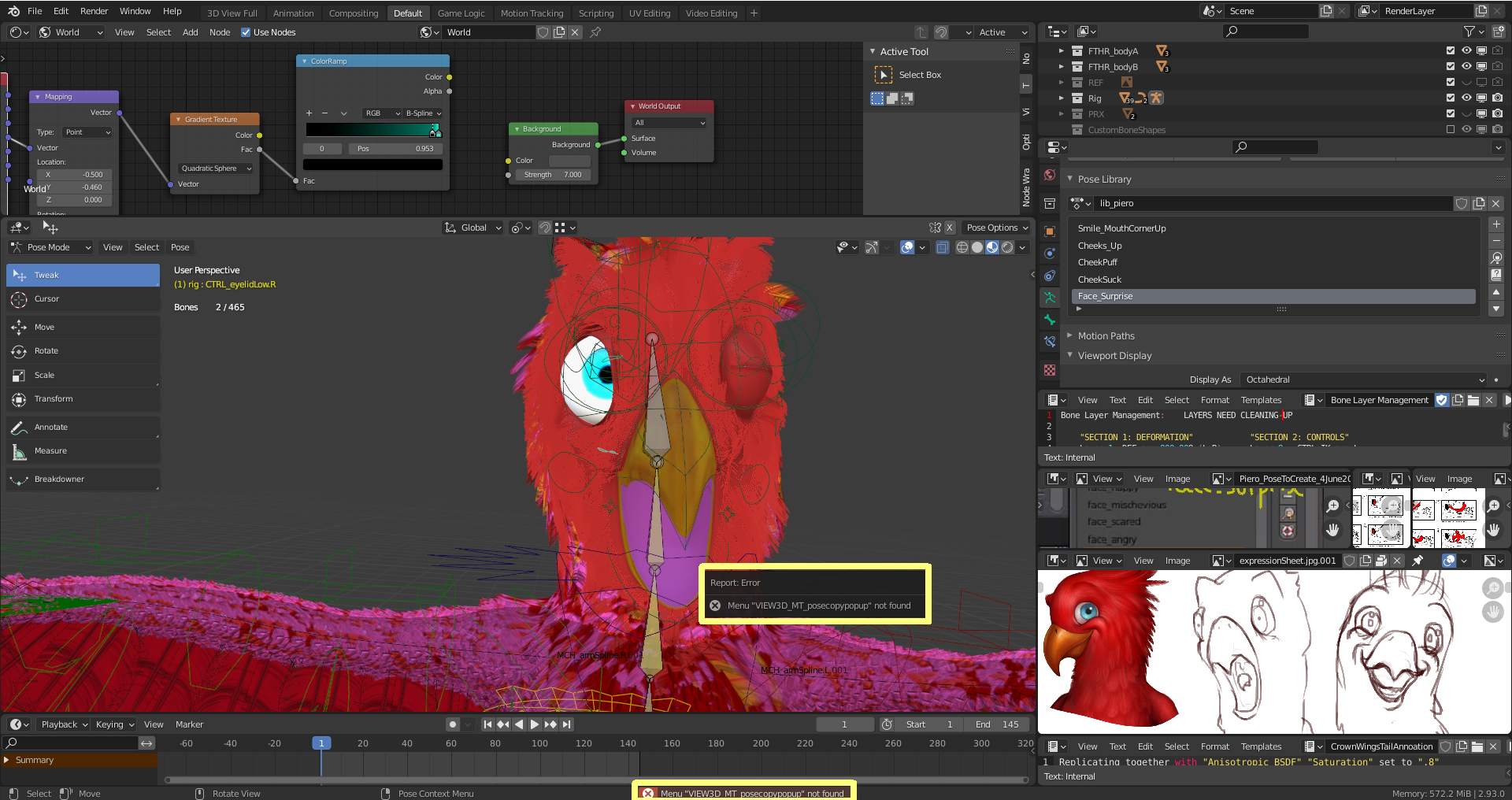

            For some reason I can’t copy rig poses of Piero in Blender 2.93 with the shortcut “CTRL + C”:
            The menu nevertheless works. If I paste the mirrored eye bones pose, it’s visible in the “Preview Rendering” but not in the “Final Rendering” (F12):
            @waylow @jlampel How can this be explained?

              Hi Ingmar,
              That message is saying it can’t find the menu that is being called.
              I have no idea how you broke Blender haha.
              I have tried to replicate this issue in 2.92, 2.93, and 3.0
              I cannot. If you can replicate this on a simple file you will be able to report it as a bug.
              Otherwise is it something specific with your file that is causing this bug.  (much harder to report)

                @waylow Maybe the error message has to to with the “Copy Attributes” addon which also uses the shortcut “CTRL + C” but I’ve disabled that addon.
                The fact that the final rendering shows one eye closed is still a mystery to me ๐Ÿค” …

                  I have a feeling that the reason it might be closed in the render and open in the viewport is because there isn’t actually a keyframe that is being recorded on the mirror side.
                  I can see in the images that you don’t have autokeying enabled.  This means that it has only updated in the viewport but that change has not been saved.
                  When you hit Render, it reads the animation data – ie not the same as the viewport if that isn’t keyed.
                  Perhaps that’s what’s going on?
                  And I hope that makes sense haha

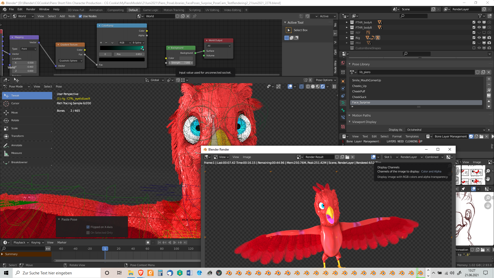

                    I’ve just seen that in the file mentioned in my last post Piero has an animation on his left eye’s lids:
                    And the opening of the left eye is part of the “Face_Surprise” pose in my “Pose Library”. I’ve saved it with that pose applied and then reopened the file. Now the left eye was already closed in “Preview Rendering”. So my conclusion: The animation data overwrites any manually set poses when it comes to rendering. I still need to keyframe the pose that I’ve set with the help of my “Pose Library”. Thank you very much, @waylow, for making me aware of the animation data. It’s essentially so obvious but with this difficult bird you sometimes don’t have an easy life ๐Ÿ˜‰๐Ÿ˜.
