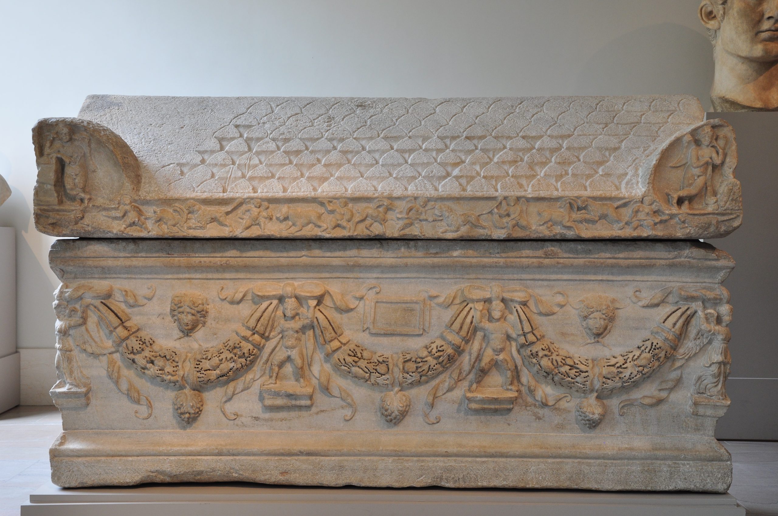

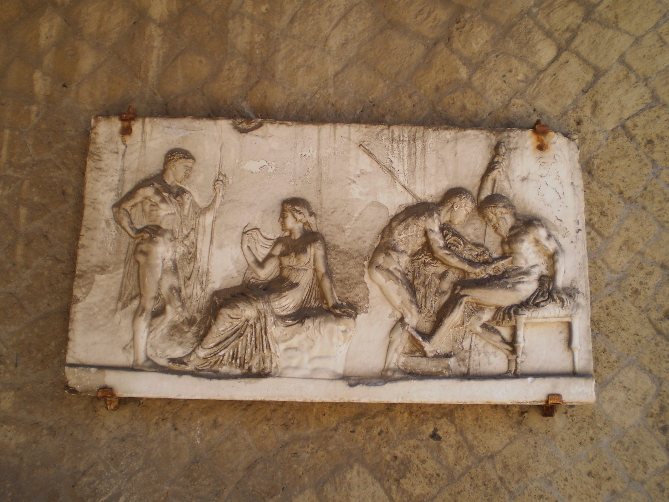

      I’m building a roman villa with all details of how life was back then. The furniture and house is not a problem, but the romans had a lot art work carved in stone. Some of them are reliefs like these:

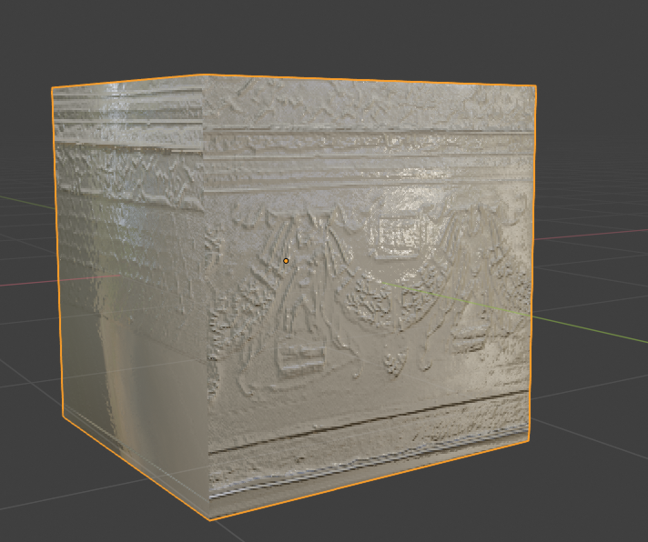

      I thought of sculpting but each one will be a big task and probably will not end up beeing as pretty. So I tried to make displacement maps or normal maps out of them for example by using http://cpetry.github.io/NormalMap-Online/ . But it looks terrible.
      The shadows are so pronouned that I get wrong results. Than I tried to make an Albedo map out of it, by adding the inverted Black/white Image as soft light to remove the shadows. althought the results are a bit better, It’s still far away from beeing good enough.
      Does anyone has an idea how to make a working is displacement map from these images?

        I’d sculpt it if I were you.  It looks to deep and defined for displacement.

          I think that @williamatics is right that sculpting will give the best result in this case…
