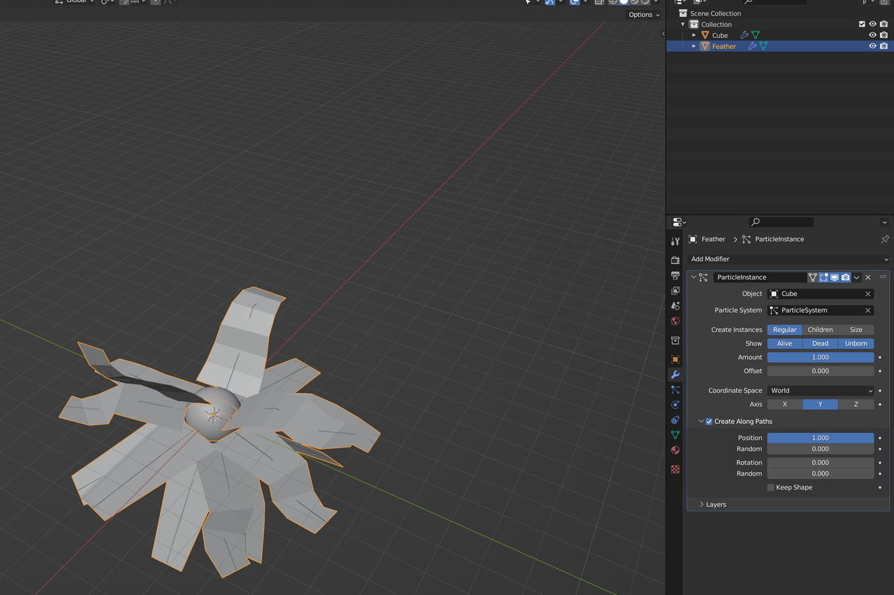

            Hi Martin,
            Use a Particle Instance Modifier on the Feather like this:
            In this case, I created a Feather along the positive Y-Axis, with its Origin at the Center of thew World.
            (You might also need to check the ‘Keep Shape’)

                The skewing should be fixed when using the Keep Shape option…the Rotation..I don’t know, but I probably wouldn’t Apply the Rotation of the Instances…It can be really finicky, but it should actually work…and it’s the only way I know, unless you want to use Geometry Nodes (but I wouldn’t know how to do it with GN…)

                    Oh, I think Daniel Bysted said that the Object you are Instancing, should be modeled along the positive Y-Axis…
                    Might be, that, as with Bones, the Y-axis of a curve is along its length, maybe?
