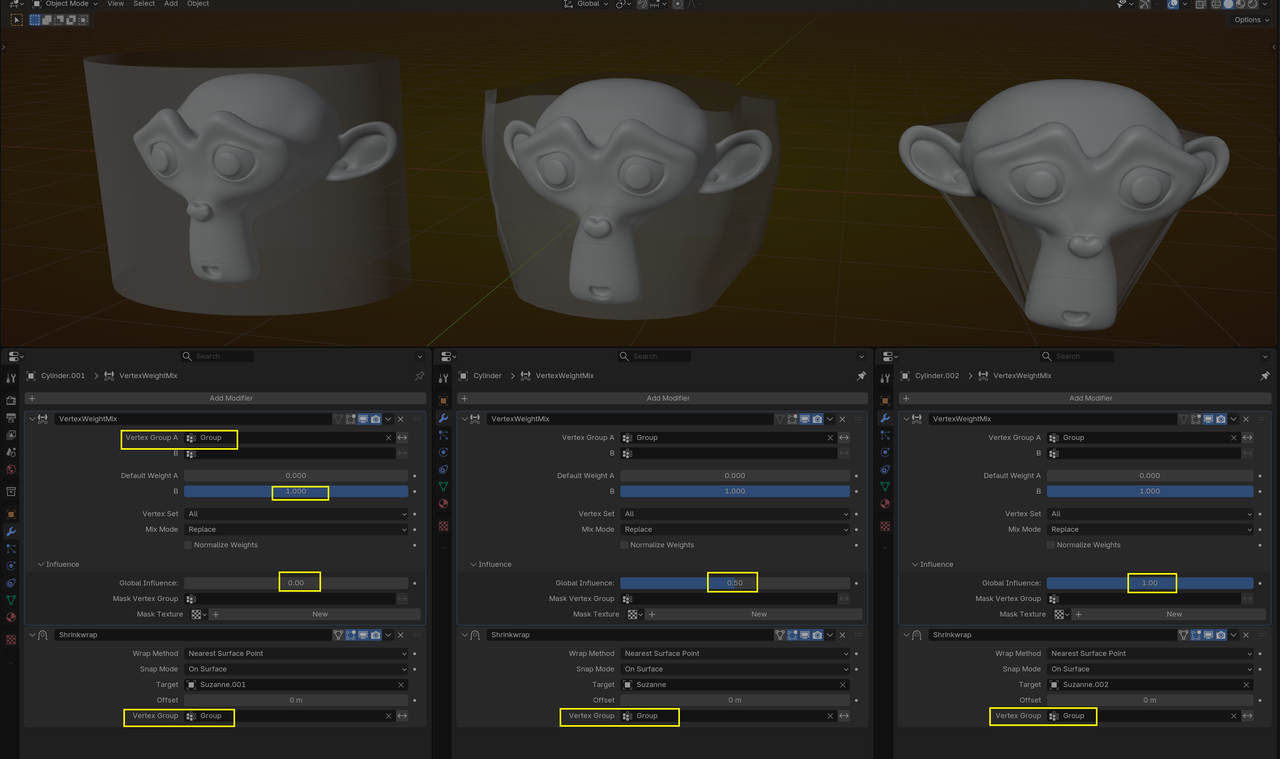

        The basis is a Shrinkwrap Modifier. The problem is to make the transition from ‘unshrunk’, to ‘shrunk’, because the Shrinkwrap Modifier doesn’t have some thing like an Influence slider.
        Maybe the simplest way, would be to Assign a Weight of 0 to all Vertices of the wrap (a Cylinder in this example) and change that over time to 1, with for instance a Vertex Weight Mix Modifier:
        look at the Course Modify, for a refresher on the Shrinkwrap Modifier.

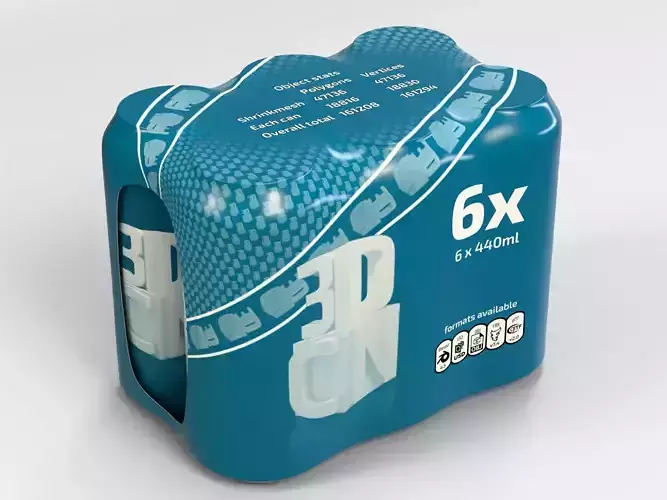

                Sorry for the misunderstanding, I’m not looking for animations, I’m interested in the final results after wrapping. I’m a packaging designer working on artworks for shrink sleeves for beverage cans, so I’m looking for a solution to show my work to a client. I’ve added an example below. Thank you!model-c28ecb1f46.png
                #99817
                  That’s just the Shrinkwrap Modifier then.
