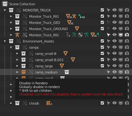

      Hi I somehow can’t hide the linked objects in the render and display view or disable the selection (Except of the monster truck). BUT I can hide it in the 3d viewport. I get this error:
      Does anyone know what that means and what I did wrong?

          @pohrerhub You haven’t done anything wrong,
          This just means the linked objects cannot be edited.
          When linking into a file with library overrides, Blender creates overrides of a lot of data blocks, to reduce the amount of information and risk of potential unwanted editing, most of those data-blocks are marked as non-editable by default.
          There is a lot to learn on Library Overrides, check this on Blender.org for more info.
          Ideally you would make changes in the original file.
          You can make a data-block editable by right clinking the object in the outliner > ID Data > Make Library Override Editable
          I hope this helps

            Yeah that helped thank youu
