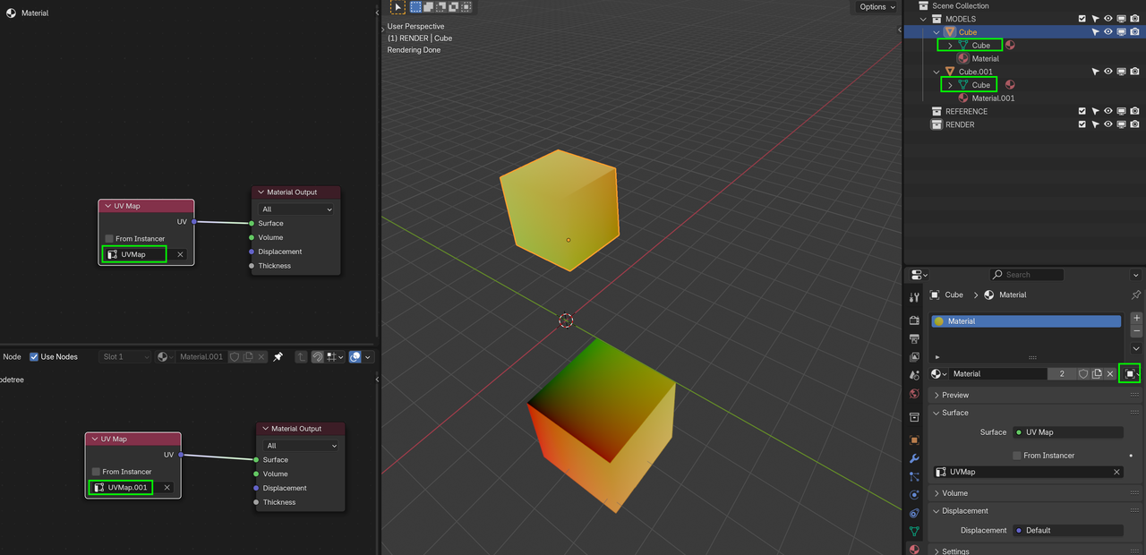

          And you can have different Materials and different UV Maps for Linked Duplicates (using more Memory than with one Material and UV Map, but less than not-Linked Duplicates):

            And thanks for the example with the UV Maps, that will definitely come in handy.
