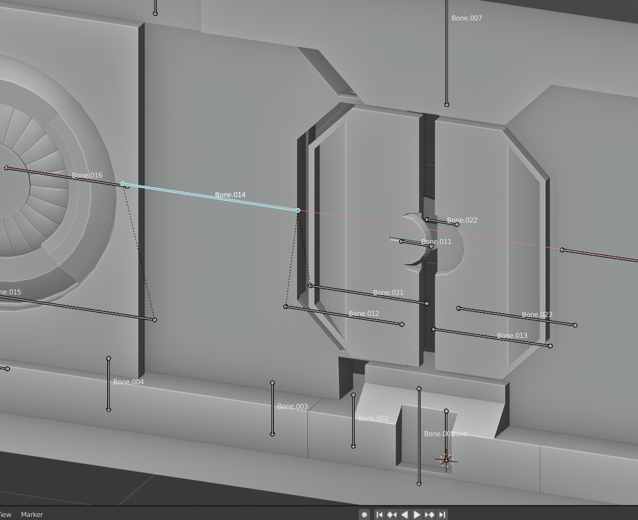

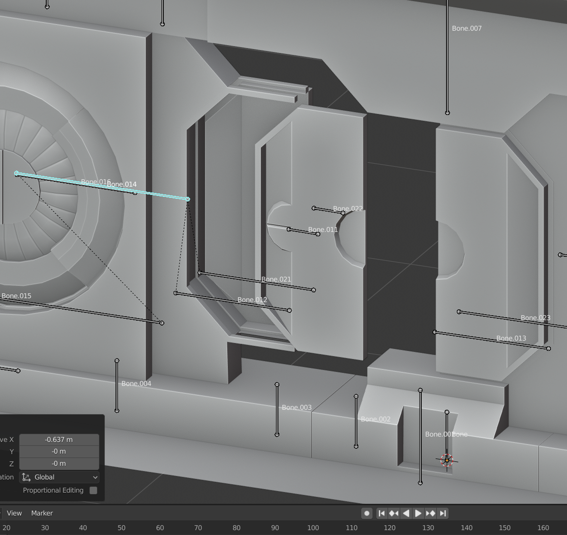

      Hi,
      I’ve got one vertext group that moves half the distqnce the associated bone moves;
      I’ve not added constraints yet. I canoot see anything different between the Bone.012 vertex group and for example the Bone.021 vertex group.
      Any idea what’s causing this, and how I fix it?
      Thanks
      Mike
      #53398
      Jonathan Lampel
        Hey Mike, that could happen if that group is also fully assigned to another bone as well since it’ll average the result. If you remove them from every other bone you should be good to go!
        #53399
        Mike Dodds
          Thanks Jonathan 🙂 That was it. It was assigned to the master bone.
          Cheers
          Mike
