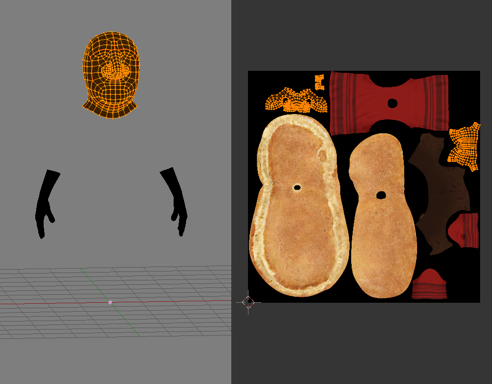

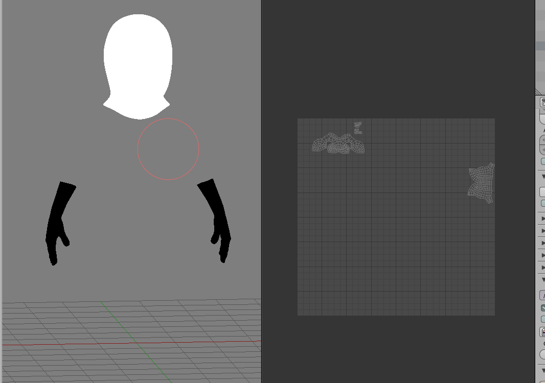

      If I assign the UV’s to the paint image, then go into texture paint mode, the menu at the bottom switches to another image (so does the one in the actual UV/image editor window) and the model appears white. I can’t paint on it.
      In edit mode:
      in texture paint mode:

        Are you painting with Blender Render enabled or with Cycles enabled?
        #26760
        Cortnie Johnson
          Blender render…
          #26761
            Ok cool – this is the texture slots thing. Since this pancake hobo course was recorded, they changed the way to paint using Blender Render. Check out the beginning of this video, starting at 3:30, to see how to set it up.
            #26762
            Cortnie Johnson
              Oh my goodness finally! Thank you!
