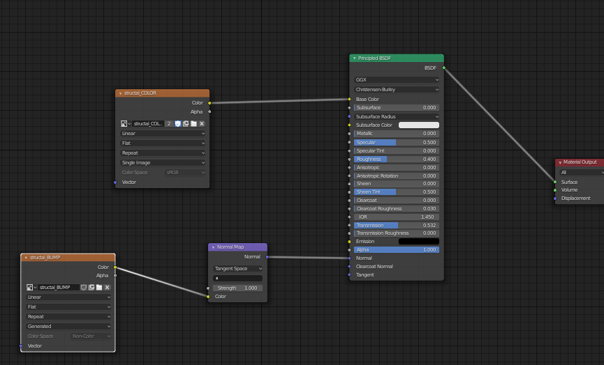

          I have the same issue but I use Blender 2.92. I could really use some help. Thank you!
          I packed myfiles here:
          https://www.dropbox.com/s/aiwcz14fbkon4hb/CGCookie-SciFi.zip?dl=0
          #57285
            Use a Vector > Bump Node instead of  a Normal Map Node.

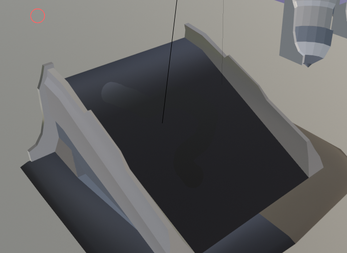

            #57286
            Adrian Bellworthy
              I just checked your file and you have some flipped normals on the ramp, in edit mode press A to select everything, press ALT + N and select Recalculate Outside, this will ensure your normals are all facing out.
              To check your normals turn on face orientation in the overlays drop down menu.
              You need to have blue facing out for the normal map to work correctly. You also need to flip one of the wall pieces.

              oleh
                Thank you! that worked
