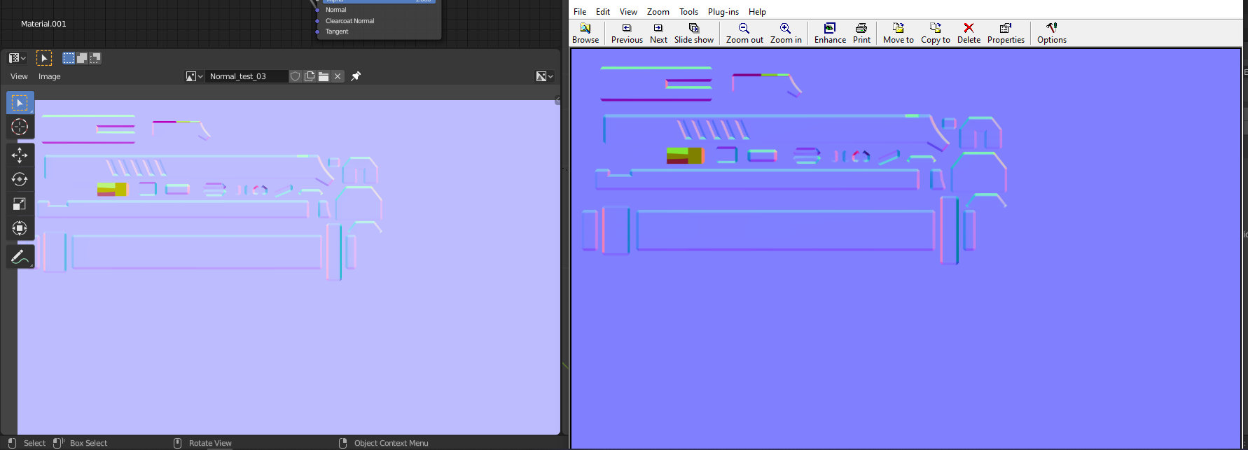

      I am have used Blender 2.80 and 2.81 Beta and  the Normal map colors are displayed different in blender then they really are. The screen shot was taken with 2.81 Beta (Build November 13, 00:13:34 – 125257758007 – Win64). Please have a look:
      Not sure what the issue is here.

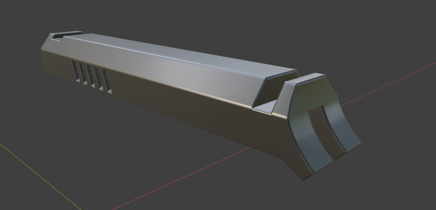

      It looks also strange in Eevee:
      About a 1/4 of a 2048 map… But that might be another issue. (Screen shot from Look Dev Evevee)

        Hey! The different colors are due to color management and file type. In Blender it’s being displayed as a full 32 bit EXR, whereas you may have exported it as a png. Also, different programs display 32 bit images differently due to different color management, so I wouldn’t worry about it just yet if you’re keeping it all in Blender. This video covers that a bit: https://cgcookie.com/lesson/bit-depth-and-compression
        The Eevee preview looks great to me, except the area near the back may be flipped. I’d have to look at the file to see for sure, but the rest of it looks totally normal.

            Aha! If you’re using a PNG you need to switch the texture node to non-color data. For 32 bit EXR’s, you can leave it on sRGB as you had it. I’d recommend baking it to a 32-bit image (hit that box when creating the image) and saving it as a full float EXR instead of a PNG.
            I know it’s kinda confusing, but that’s the only way to get it to look right!
