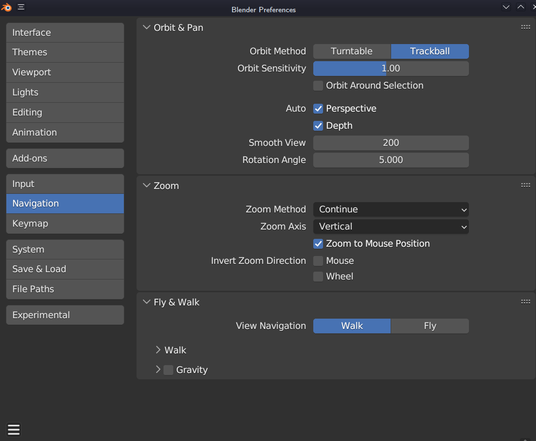

                      Would you mind sending a snapshot of your navigation preferences? I just want to see and compare. I’ve tried different combinations of settings.
                      It’s weird, the panning in 3D seems to center around the cursor not the object highlights. The panning also moves in just the X, Y axis so you can’t move in the direction your looking. And trying to get close enough to see something is nexty t impossible, it shhots you off into space if you get close, it’s very weird.I have moved the cursor and that helps a bit in getting close but still very awkward
                      #78665
                        Hi Brad,
                        my settings are pretty much like default; I think I only changed the Zoom to Mouse Position:
                        Stupid question, is your model in, or close to the center of the world? If it is very far off, that can cause really weird behavior and glitches.
