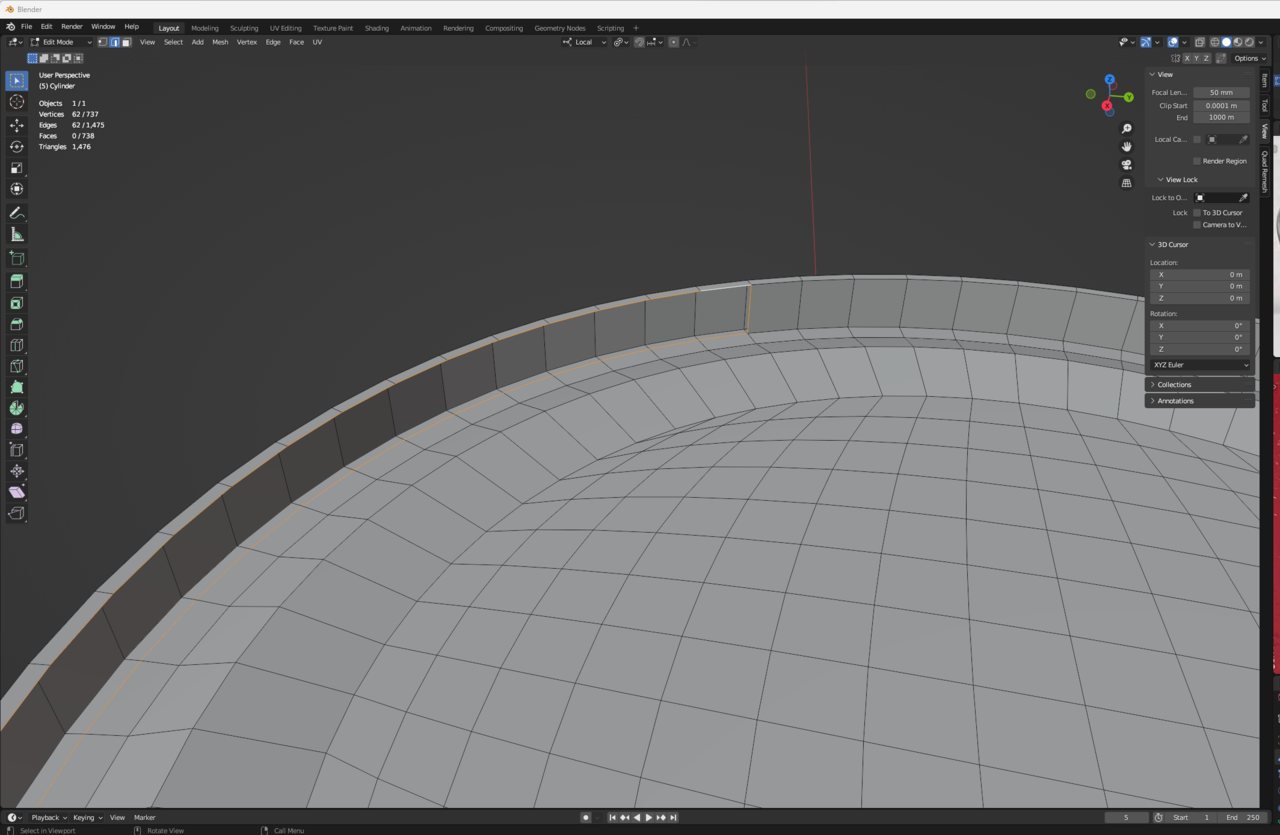

      Hi guys,
      say if I wanna create faces between these edges, how would I do it?
      So far I have been selecting the upper edge, lower edge, then F, but there has to be a better way right?
      Thanks in advance, I hope the image is readable.
      (Basically, 2 circles with the same edge count, over each other, create 1 face between each 2 alligning edges023-12-25 193242.png
      #83060
      Sascha Feider
        Select two opposing edges and press F to fill to create one face. Then as long as you have quad topology (four vertices per face) you can select the vertical edge on the face and just hold F and it will keep adding faces until you’re around or you hit an n-gon.
        Or you activate the built-in addon Mesh: Loop tools. With that activated you can select both edge loops -> right click -> loop tools -> bridge. This will connect both edge loops with clean topology.

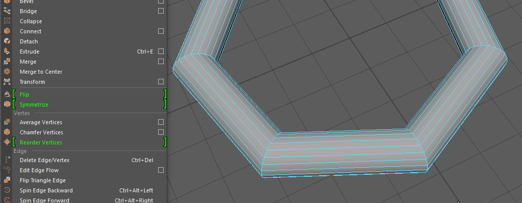

            Speaking of this, any way to do this in Blender without an addon? It’s a gif, hopefully it moves.

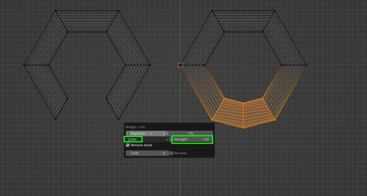

              Hi Omar, Merry Christmas!
              Not sure if this is what you mean, but you can Bridge Edge Loops and use Cubic Interpolation and play with the Strength…ridge Edge Loops.png
              This uses the Loop Tools Bridge, not the default Bridge Edge Loops.

              Nougat Time
                Oh my gah thanks guys it worked! :3
