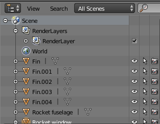

      using version 2.79; I cannot identify any way to replicate the collections function in the outliner; it is  therefore impossible to group the components of the rocket into a single asset.  Here’s what I show on my screen:
      #29085
      Grant Wilk
        As an alternative, you can just select all of the objects you’d like to put together and press CTRL+J. This will join all of the separate rocket parts into a single mesh that you can use just like I use the collection instance in this course!
