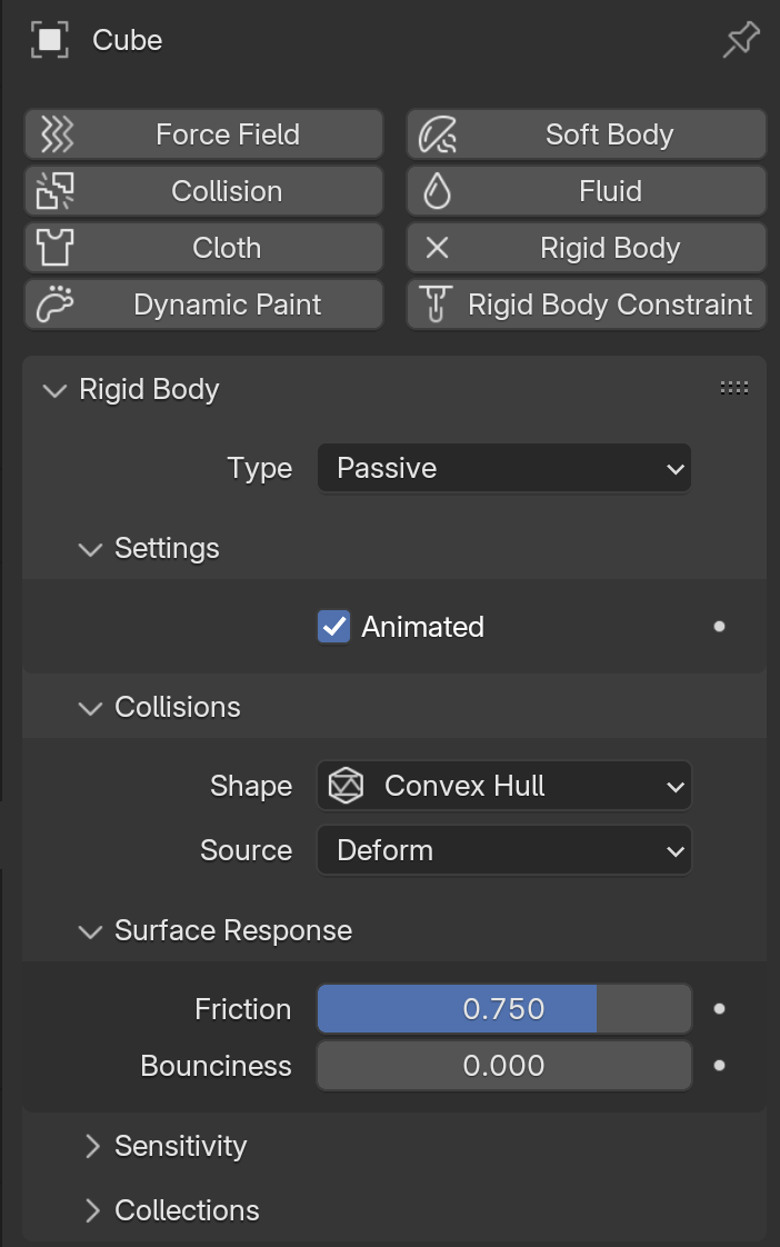

        Passive animatic bulldozer cube settings:

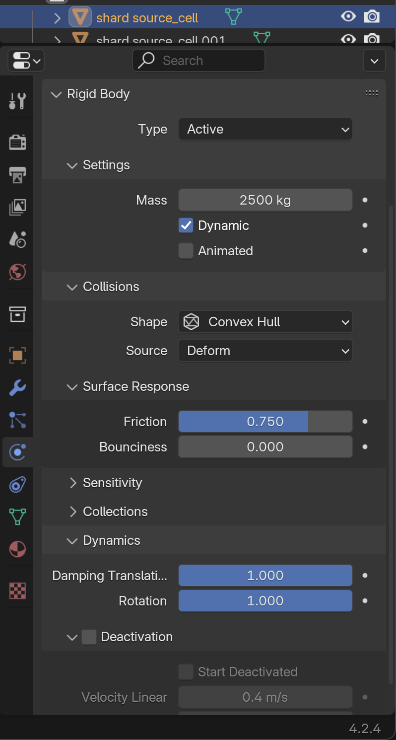

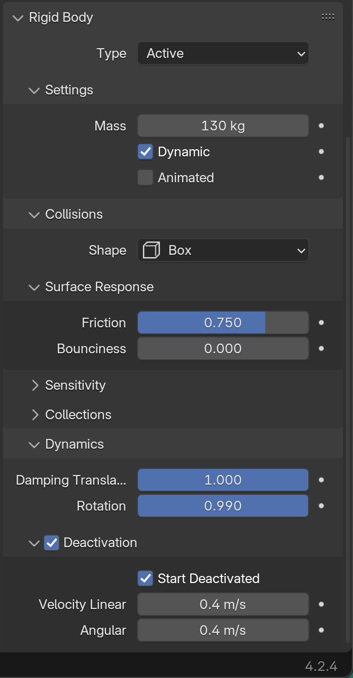

        Active animatic shard settings:

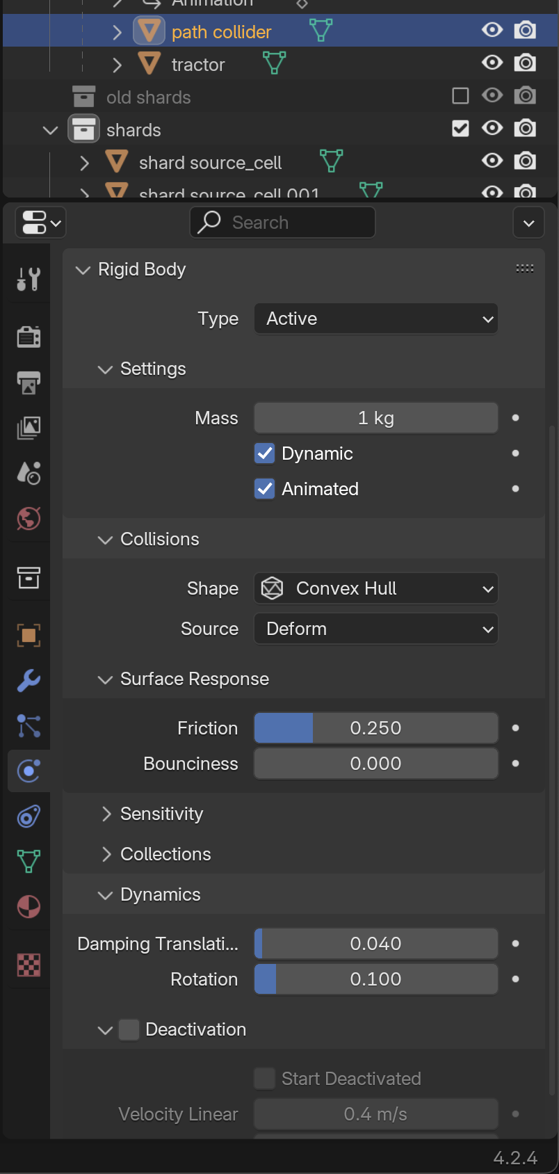

                            Your suggestions that I use a path collider with a transparent material, that I lower the friction on the collider and tractor, and that I increase the weight of the shards really helped me dial in the animation.

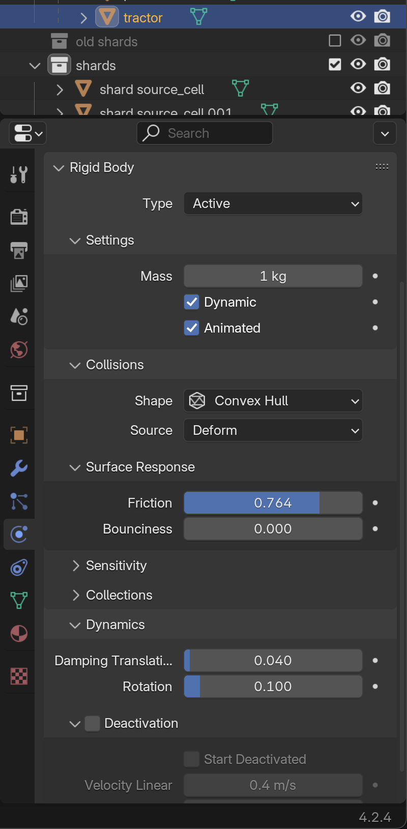

                            To finish this topic and clean up any loose ends, here’s the animatic and my tractor setup and rigid body settings:

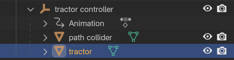

                            I can’t parent two rigid bodies to each other, but I can parent two rigid bodies to an empty!
                            Tractor rigid body settings:
                            Path collider rigid body settings:
                            Shard rigid body settings:
