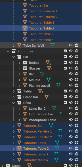

      Hello. I have the same objects twice or more in my collections. If i try to clean one collection, it deletes the objects in the other collection. After some researches on internet, i still can’t figure how to clean my collections. Help 🙂

        Hi David @Blob Marley ,
        Those Objects are Linked, so they are the same Objects in two different Collections.
        What you can do, is to move non-‘duplicates’ into a new/different Collection and then right click the Collection with the Linked Objects and then Delete Hierarchy.
        Tip: test this first on a new simple File. Otherwise, if something doesn’t work as expected, simply use CTRL+Z to Undo.

          Thank you for the answer, unfortunately that is not working. The problem seems to be that all the objects are in another object. When i try to move something, that just makes a copy and if i try to unlink it delete all the copies. Also tried to move in a new collection and delete hierarchy, every time it is the same result, i can not delete one copy without deleting every other copies. If i delete the floor, i delete everything :p

                  Thx for the answers. Didn’t work for me, event if i delete the object that is not the original, it delete the other to. The same goes by adding them in a new collection and delete the collection or the hierarchy. I would like to find a way to move out all the objects inside the object name ‘Floor’ in the picture.
                  UPDATE : Finally managed to do it. I unlinked the object ‘Floor’ (so the floor was deleted) and all the subs-objects was free again. It was messy because i moved some of them with the floor before so there were not at the right place but in the end, i just had to replace them and redo the floor. There is no more copies of all the objects and they are where they belong.
