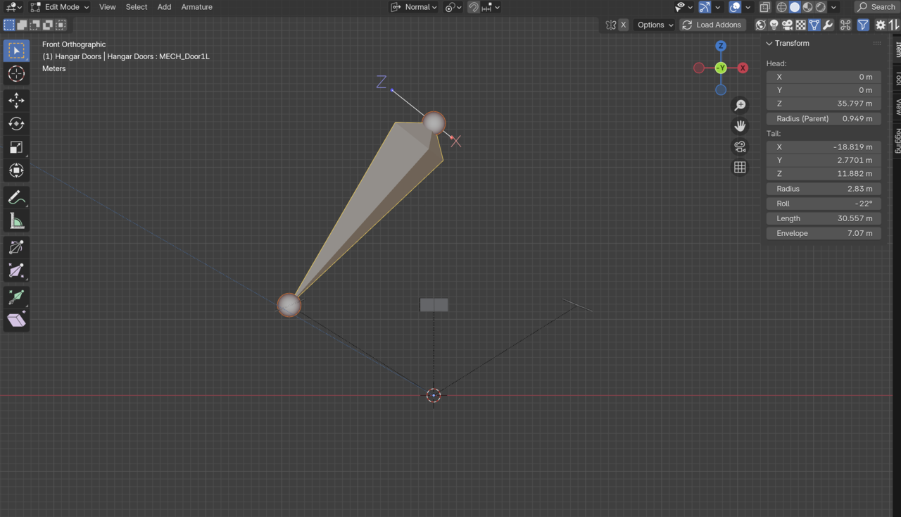

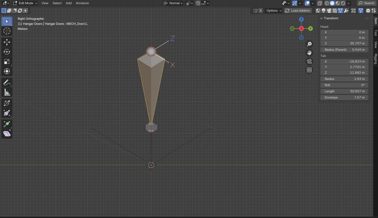

I’m confused and probably missing something obvious. With the door bone(s) orientation, connected to and relative to the root bone, I don’t see any way to align either the X or Z axis with the world Z-axis using only the Roll parameter. Screenshots attached.
I like where you’re headed with this, I’m just not executing it very well. Thank you for your continuing help! 🙏🏻
Don’t move/rotate the bone. Think of the X or Z axis as your hing. That is the axis you want to rotate around. While thinking like that adjust the roll setting under the transform panel on the right hand side until the axis is aligned with how you want to rotate around.
