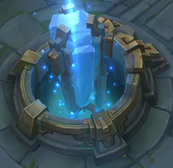

      And so the adventure started. First off, the reference material:
      Ingame, the crystal is completely solid, has no refractions, no translucency or anything fancy at all. That is due to the artstyle of League of Legends, everything looks painted. Which is nice, but not what I want.
      So I need to improvise here and create an interesting crystal material that still incorporates the main features of the reference image.

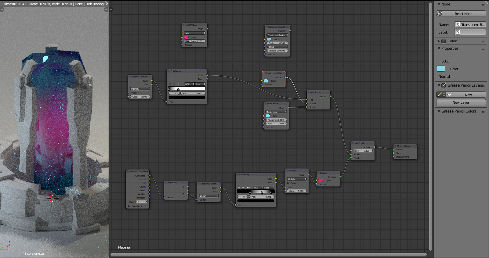

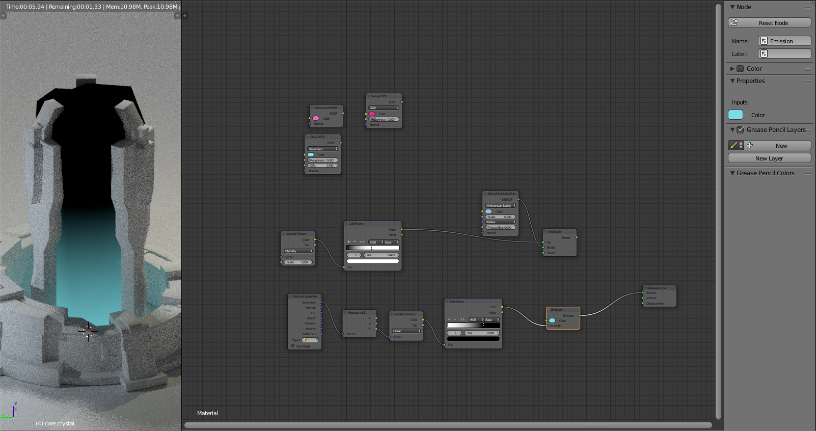

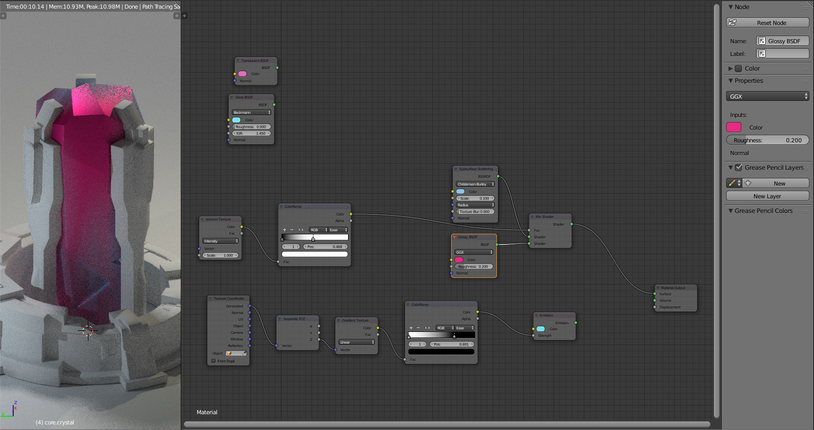

      First off, I want the crystal to feel like it is charged with energy or magic. I want it to emit light from the inside.
      Since I didn’t want the entire crystal to emit light, but make it seem like the emission is coming from the inside, from its’ core, I took the generated coordinates of the crystal, and channeled the Z axis into a gradient texture followed by a colour ramp so I have precise control over the gradient.
      The result is piped into the strength of the emission, setting a smooth transition from “lights on” to “lights off”. So far so good.

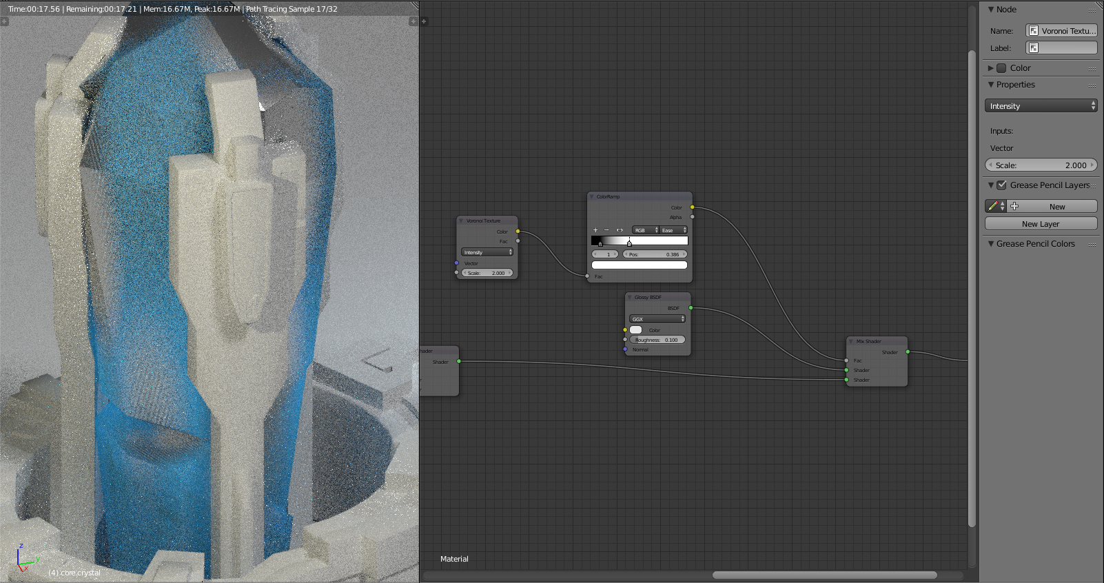

      After that I set up a simple surface with an SSS and a glossy connected into a mix shader, while the Voronoi texture controls the shaders. The colour ramp again helps me to control the spread and smoothness of the voronoi texture.
      To make it easier for me to see how the shaders actually play into each other, I have chosen a bright pink for the glossy and a smooth blue for the SSS and you can see that the glossy is dominating by far. Looks interesting too but I don’t want a metal core.
      So the glossy look made it to metallic, was not what I wanted. Replacing glossy with translucency did the trick. I now switched the emission light to pink to determine how strong it was and as you can see here, the emission is getting dulled out by the SSS shader.
      So, a couple of quality of life adjustments to the emission. I added a Math Converter set it to multiplay and the value to 5 to increase the strength of the emission without messing up the smoothness of the colour ramp.
      Then I added another handle into the colour ramp to move the emission to the actual core of the crystal. Much better.
      The translucency made it look interesting but now it reminds me of expensive designer hard soap.

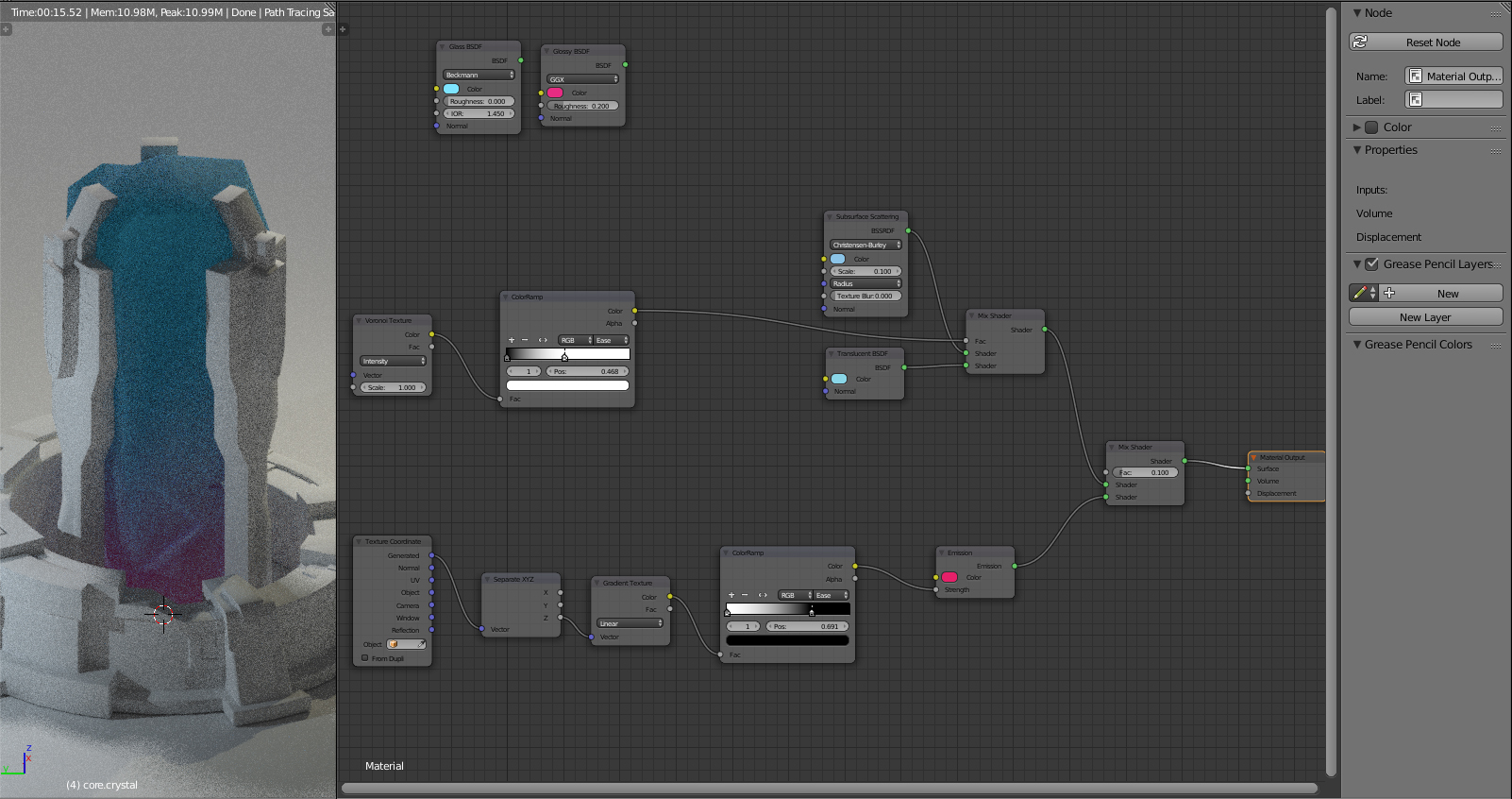

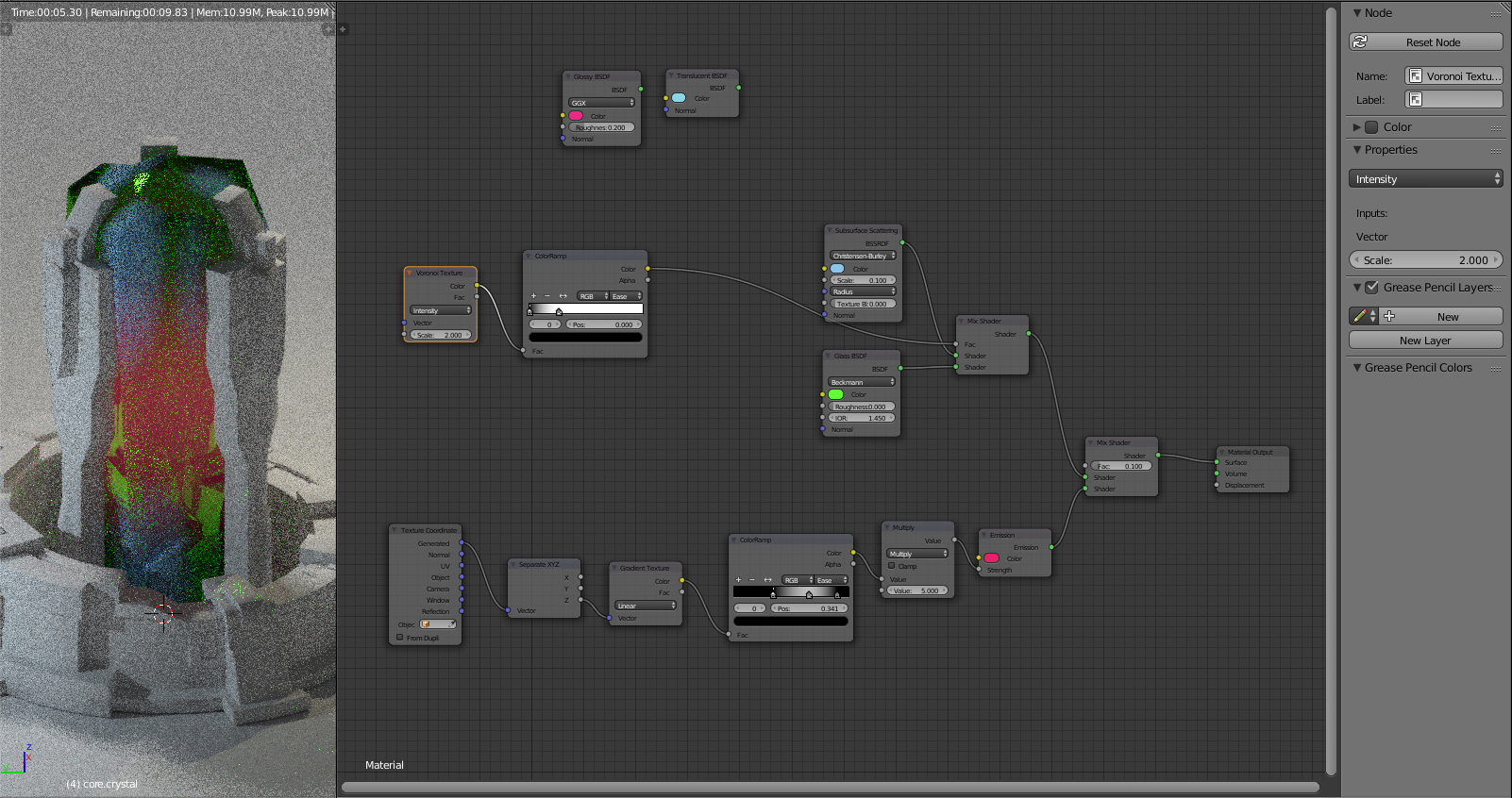

      So I replaced translucency with glass, gave it a nice green colour so I can determine how strong the shader is.
      Here I replaced the SSS with Translucency, which gave it a really nice looking effect but it reminded me more of a decorative type of gem or crystal, and I want one that is visibly used for accessing some sort of power/energy.

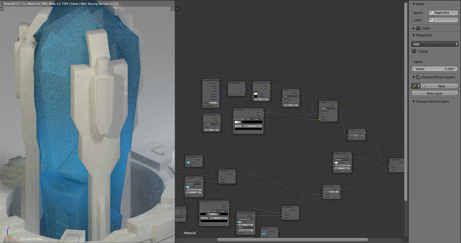

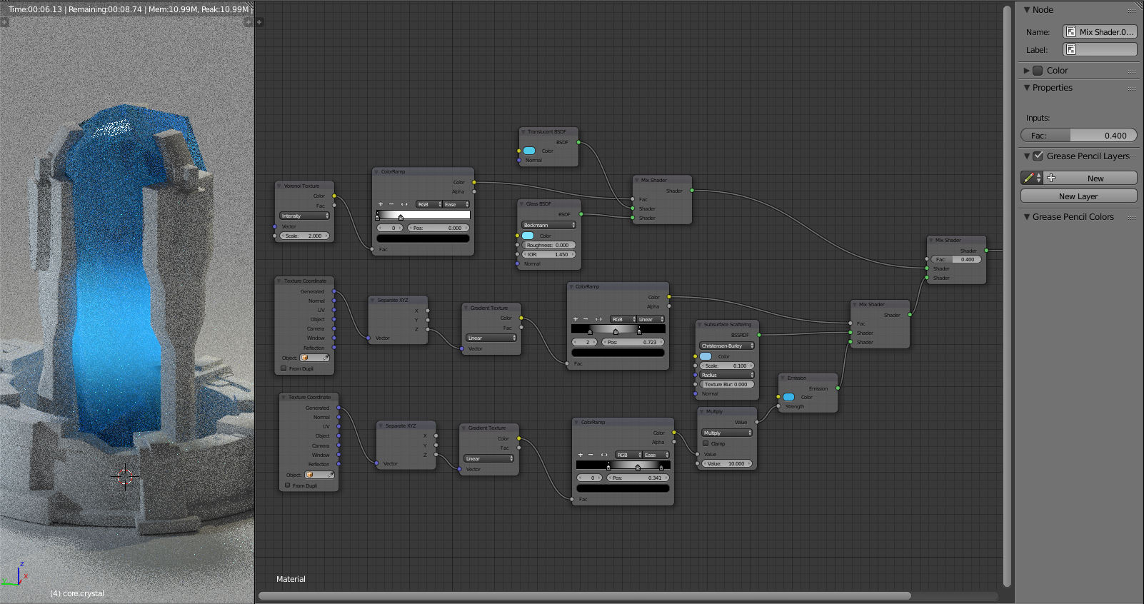

      So after a lot of experimenting I copied the vector and colour ramp information from the emission shader, adjusted the colour ramp to be slightly above the emission one, channeled the emission and SSS together into a mix shader and the colour ramp output into the factor giving me a very nice solid looking crystal type of look.
      The transparency and glass shaders give it a nice touch around the top edges. That was very close to what I had in mind.

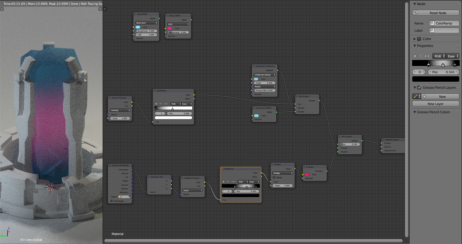

      After a short break I looked back at it and the emission was way off. It was too strong and looked unnatural. So I went ahead, toned the multiplier down, adjusted a couple of other things and this was starting to look very good! 😀

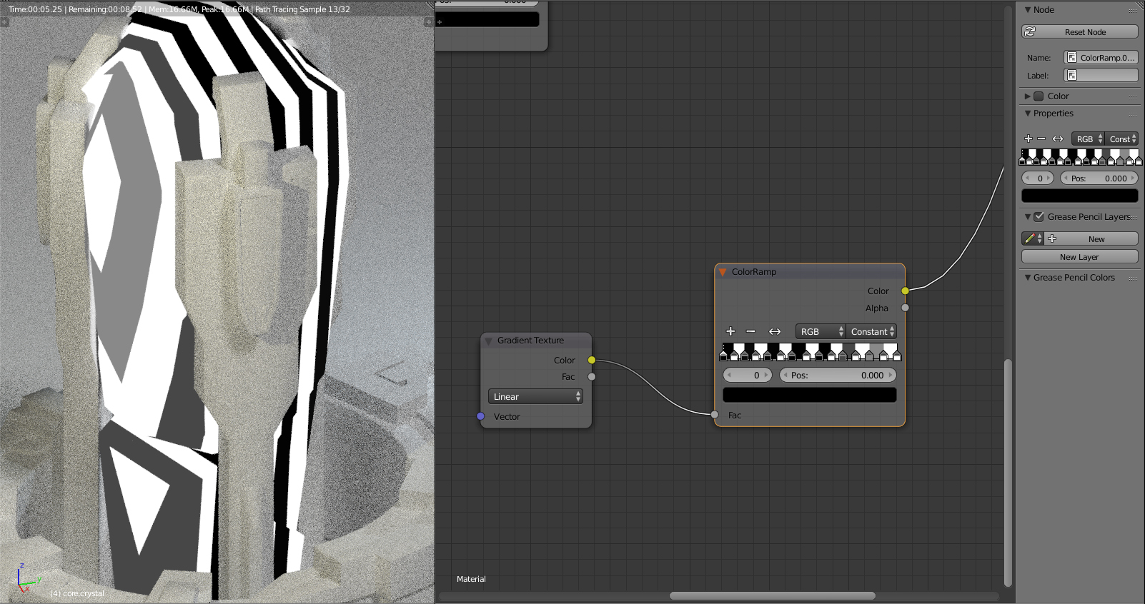

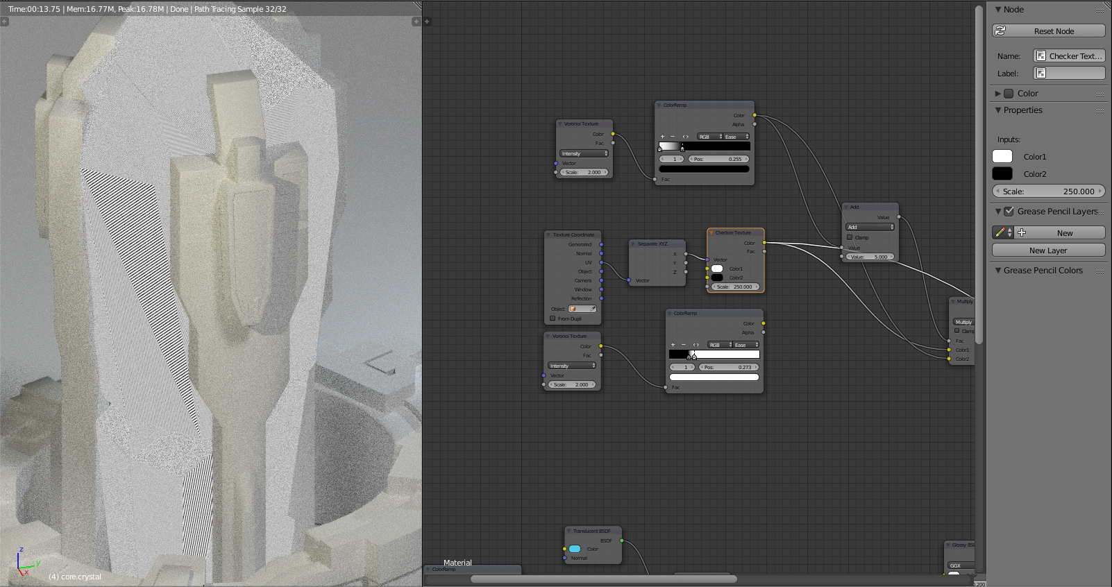

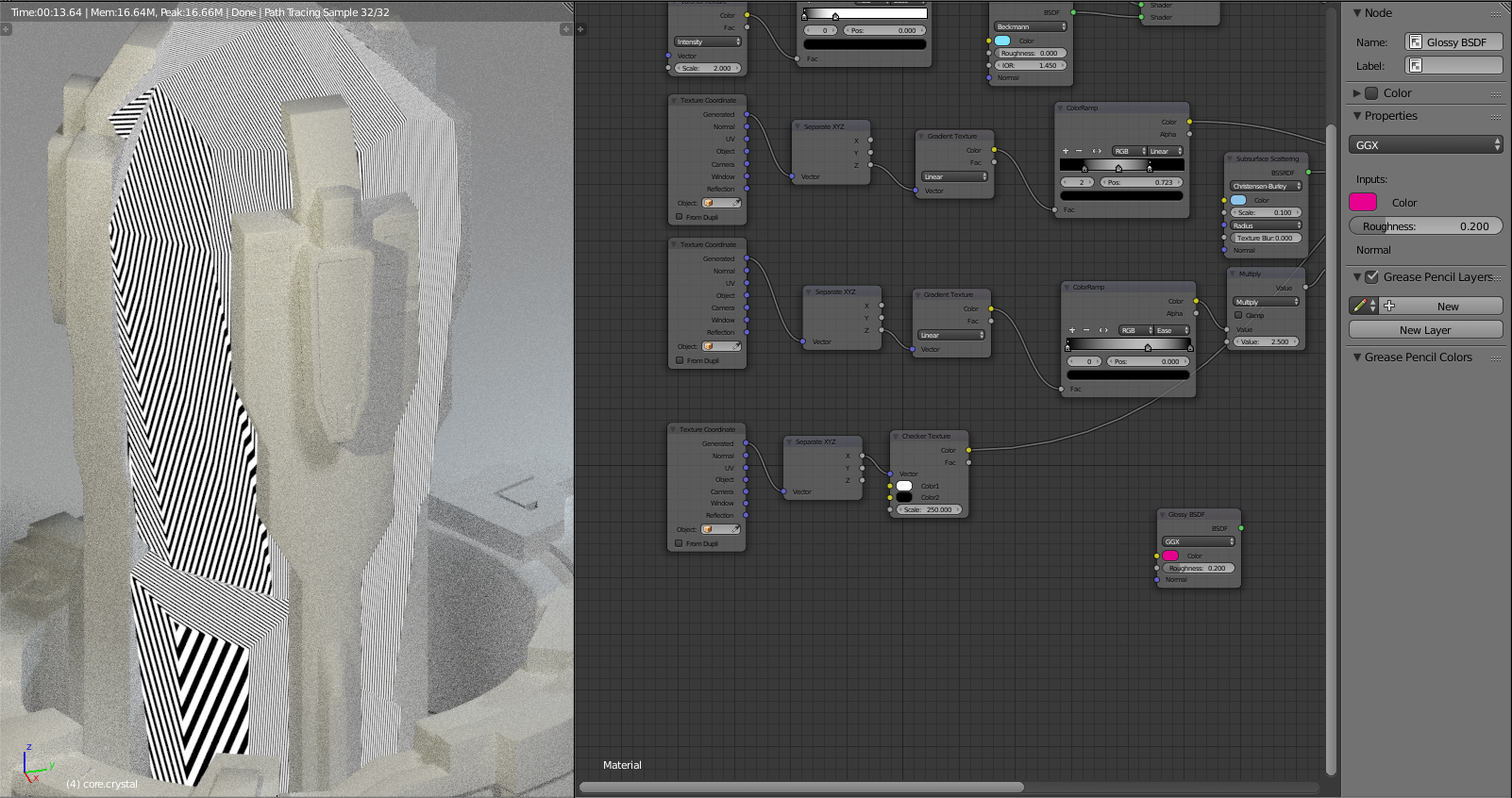

      So first off I went with a linear texture and a colour ramp and started adding a bunch of handles trying to get a striped look.
      Lemme tell you that setting up these 11 handles took me a solid 4 minutes and it needed to be much much more subtle and detailed.

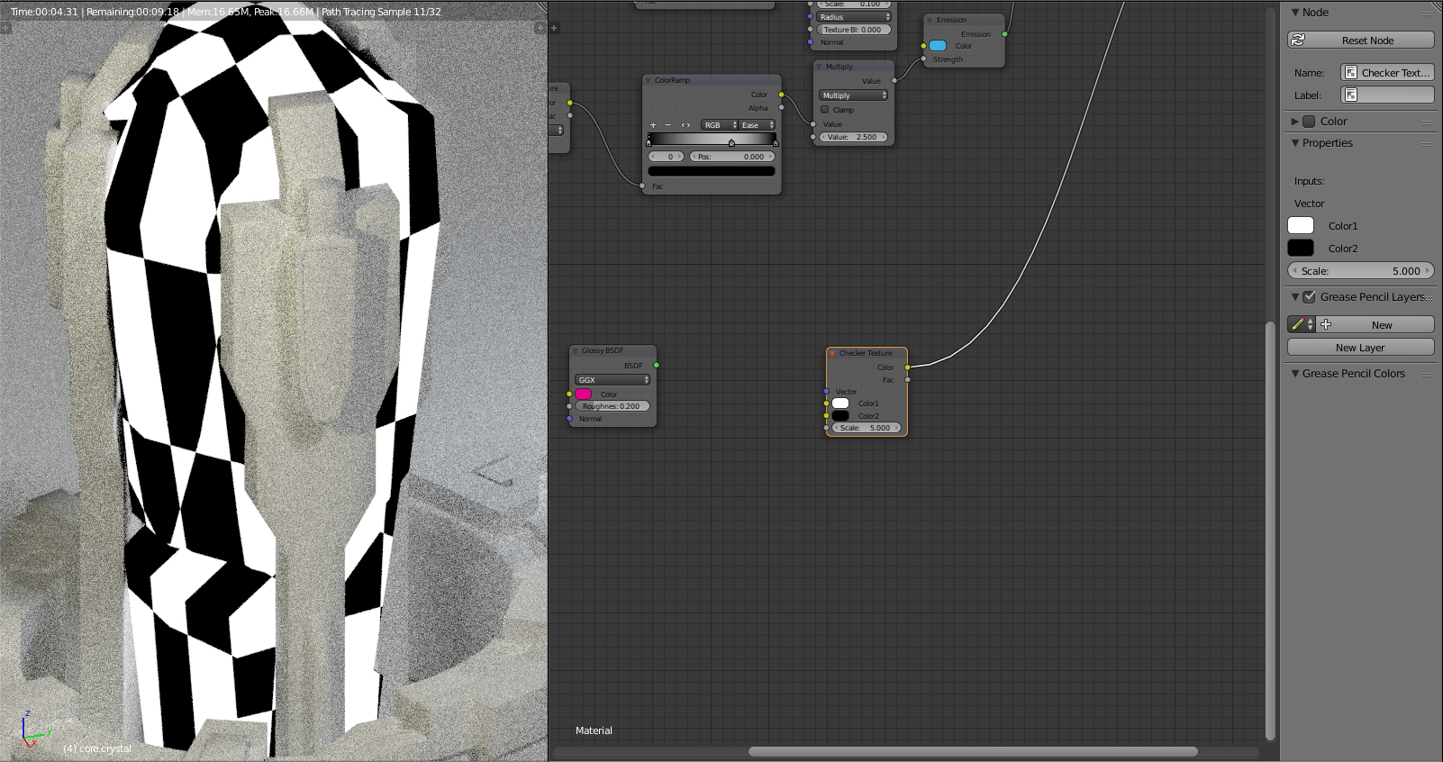

      So, hello Checker Texture!
      Now to achieve the striped look with squares, I need to restrict the texture to one vector.
      So I took the vector coordinates and seperated them, which game this nice radiator look. The stripes on the side are still too thick and I also don’t want the entire crystal to have these subtle highlights, so there is still some adjustment to be done.
      For now the stripes are fine, I know they work and I first want to get the result I’m looking for and then I can still adjust the stripes themselves.

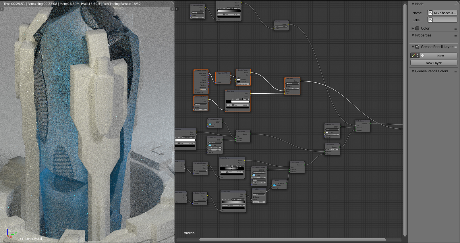

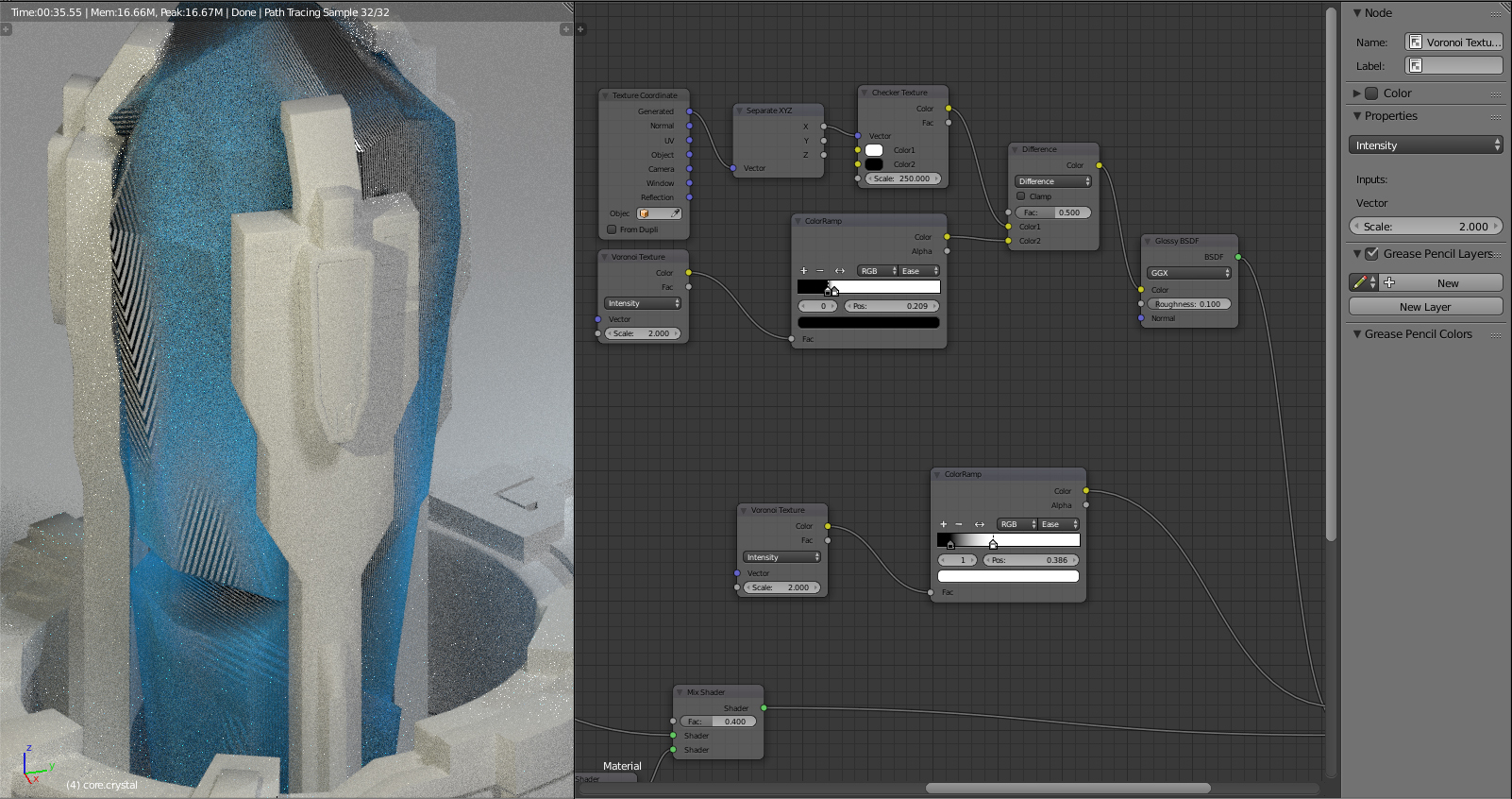

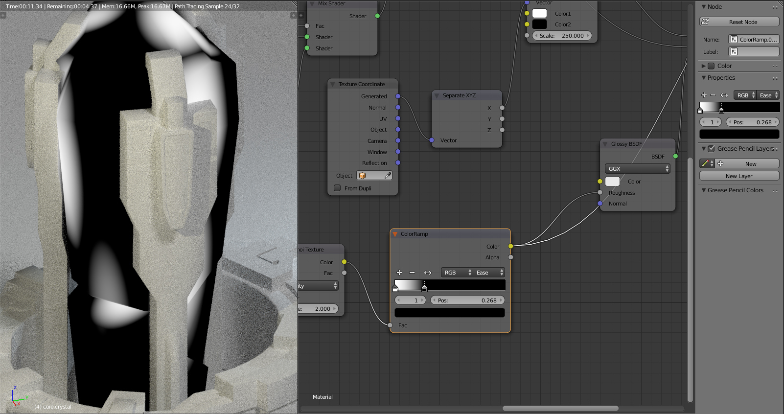

      Once again, I summoned Voronoi texture, adjusted it with a colour ramp and tried to channel it into the shaders and factors so that only the white parts would be glossy. Many issues came with this, it still turned the entire crystal into a glossy monster.
      Hello, why is it black and silver? No?
      Nope.
      No displacement. No-No. I want my smooth surfaces.
      And FINALLY I figured it out after 3 hours of intense node stuff, get some adjustments on the stripes. Changing the vector coordinates from Generated to UV made the stripes more even and finer, now I had to tone down the scaling otherwise you wouldn’t be able to distinguish the stripes anymore.

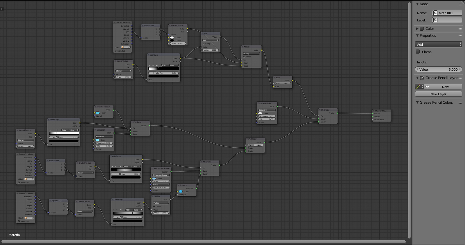

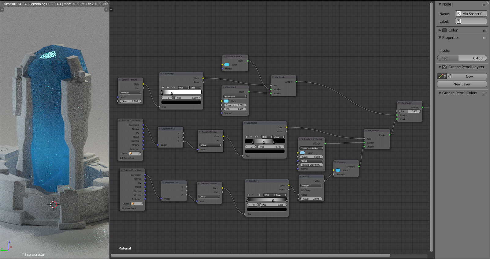

      I skipped some steps, because I didn’t want to make this post too large, despite the warning in the title, but here is a complete and final screenshot of my node setup.
