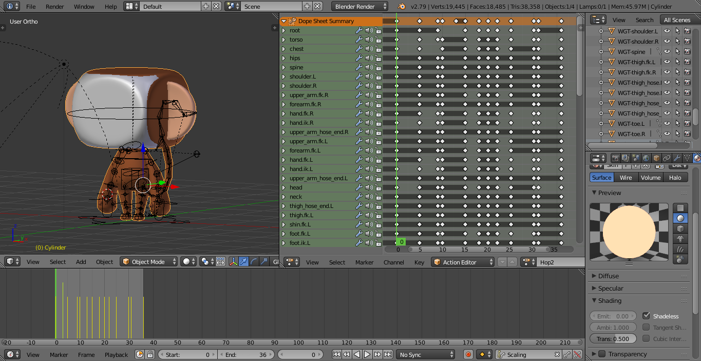

      1. I made 5 different animations (called Hop1 to Hop5) in which a monkey (the character I modelled) jumps in different ways. The thing is that when I play them one by one, all of them look the same -just like Hop2, although the Dope sheet shows different frames in each one. I tried to fix it making some changes in the other animations, but I think that the problem is that none of them are able to be seen but Hop2.

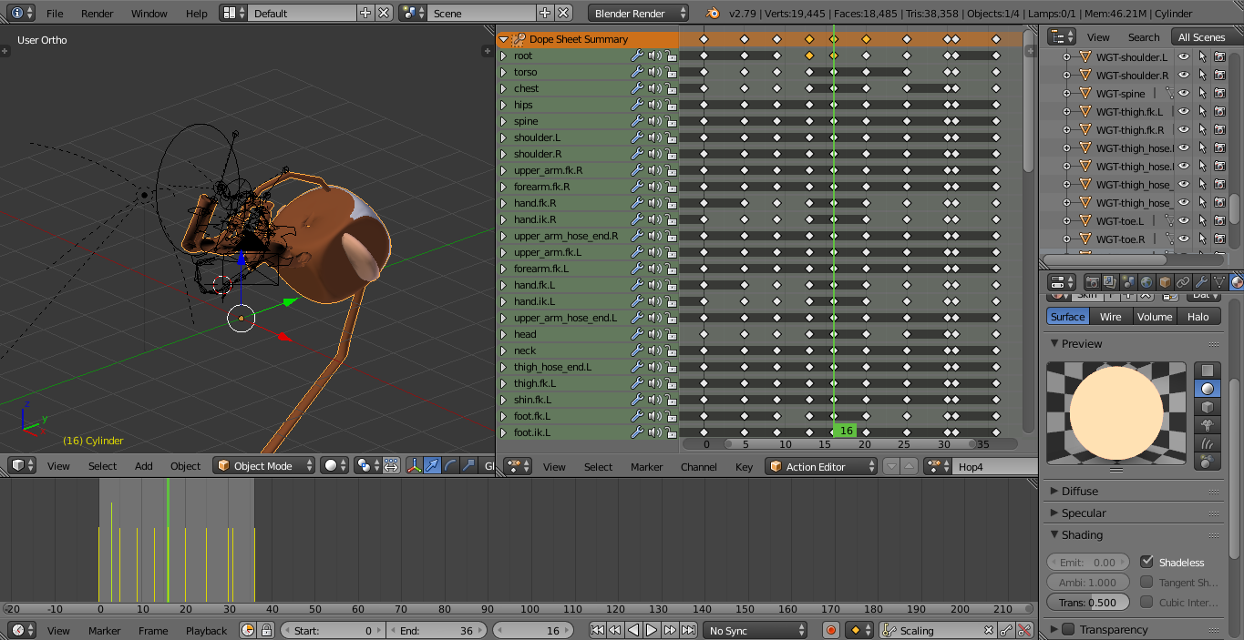

      2. When I select animations Hop4 and Hop5 the figure of the character gets deformed and it’s no longet put back in the correct posture, even if I turn back to the other animations.

          it’s my understanding that each animation needs to occupy a different place on the timeline…
          for instance hop1 is from keyframe 0 – 25
          then hop2 is from frame 26 – 50… and so on…
          it looks to me as if they are all stacked on top of each other…
          hope this helps…

              Anyway, I’m trying to delete the animations to leave one in each blender file but I don’t know how. With the option “remove animation” all it does is remove the animation from de figure, but it doesn’t delete it.

                ‘I made 5 different animations (called Hop1 to Hop5)’
                How did you organize those animations ?
                You can have as many animations as you want on an object but you have to assign a separated action to them and organize those actions in the NLA editor.
                If your character is jumping up one time and doing a walk cycle the other time, you make an action for the jump, an action for the walk and in the NLA editor you can organize those actions so it jumps, walks, jumps, walks jumps, walks …
                So, how did you organize those animations ?
                To delete an animation from an object you select that object in the ‘Outliner’, expand the object’s directory by clicking the little ‘+’ sign in front of it. Right click on ‘Animation’ and select ‘Clear Animation Data’. In the action editor a ‘0’ will appear in front of this action and this action will be gone, next time you open Blender. Or unlink the action from the object in the action editor itself by clicking the ‘x’.
                It would be a help if you could post the file so I can see what you are talking about and what you have done.

                    You have muted all tracks in the NLA editor, so I unmuted all.
                    Playing back the animation, your dude jumps. What do I have to look for what your question is of this topic. I see no deformation of your charachter..

                      I already solved the problem of the deformation. Thank you!
