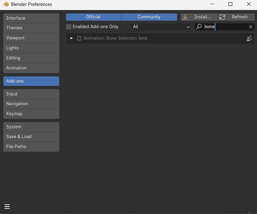

          Hi Wayne, yes, I sent the photos. The issue happens when I try to download the bone weight add-on. In Blender it says that it’s installing, but when I search for it, it doesn’t show up. I’m currently using Blender 4.0—and in case you’re wondering why, it’s because the video I’m following uses Blender 4.0, so I want to match the same settings. That said, I’m also familiar with the newer version now, and I think that might be why I’m stuck. Thanks, Wayne—I hope this makes sense.

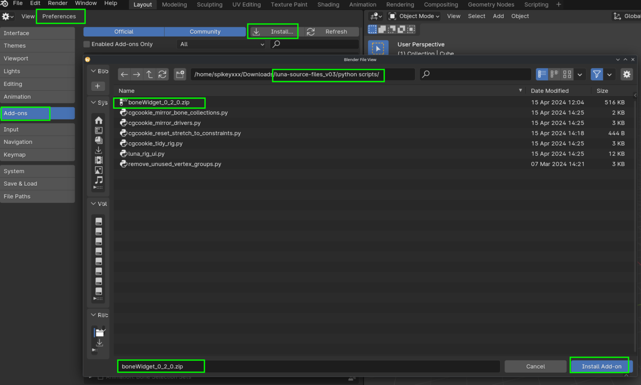

              Hi Tian,
              If you use the one included in the Course Files, it works in 4.0:
              This version is also available on Github.

                I think I know the issue.
                That version you downloaded is bundled as an extension.  However Blender 4.0 doesn’t know what extensions are – as they were introduced in 4.2+
                So it will install it correctly, but 4.0 won’t be able to see it (any version from 4.2+ will be able to see it)
                So you can install the version that is bundled with the course files as Martin showed – this will work with 4.0

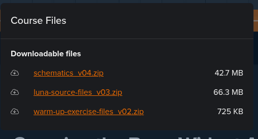

                    Francis Ogidiagba
                      is it course files or download files
                      #99691
                      Wayne Dixon
                        Hi Francis,
                        Click on “Download Files”
                        Then in the look in the “luna-source-files_v03.zip”
