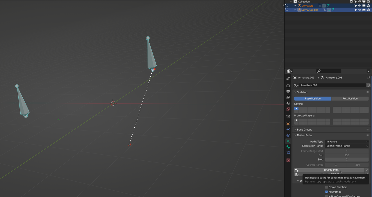

      Do you know if it is possible to show only one motion Path but you have all RIGs selected. I sort of prefer it this way but when I update the MP it shows all Paths at the same time which feels uncomfortable….

        I’m sure Wayne has a better answer, but when you are in Pose Mode, you can remove Motion Paths per Bone and the Update will only Update the Bones that already have Motion Paths:

          Sadly no.  Blender will pretty much do what you tell it to do (most of the time).
          So when you have all the bones selected and you calculate, it’s going to calculate all the selected bones.
          I find myself clearing the cache and recalculating when I need to, but I have those functions added to my quick favourites.  This can save a bunch of time.
          Also I find myself using ‘around frame’ rather than ‘in range’ a lot more these days, as it keeps the view cleaner.

            Thank you Martin and Wayne, yep, add to shortcut or adding this to my Stream Deck is my solution…since now :-))
