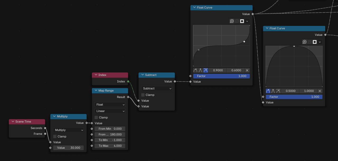

      I was following the Motion Graphics Transition Effect in Blender’s Geometry Nodes video and wondered how to make each instance move from start to end position one by one.
      #92722
        Hi Ahmed @a7medkhaled.me ,
        I hope I understand you correctly; you can use the Index to manipulate Instances individually. For instance this will move the Spheres up and down, one after the other:
        #92723
        Ahmed Khaled
          Hi Martin, Thank you for your time.
          This actually helped me create the effect I was seeking. It’s not exactly the same, but the most important thing is that it worked!025-01-17 194851.png
