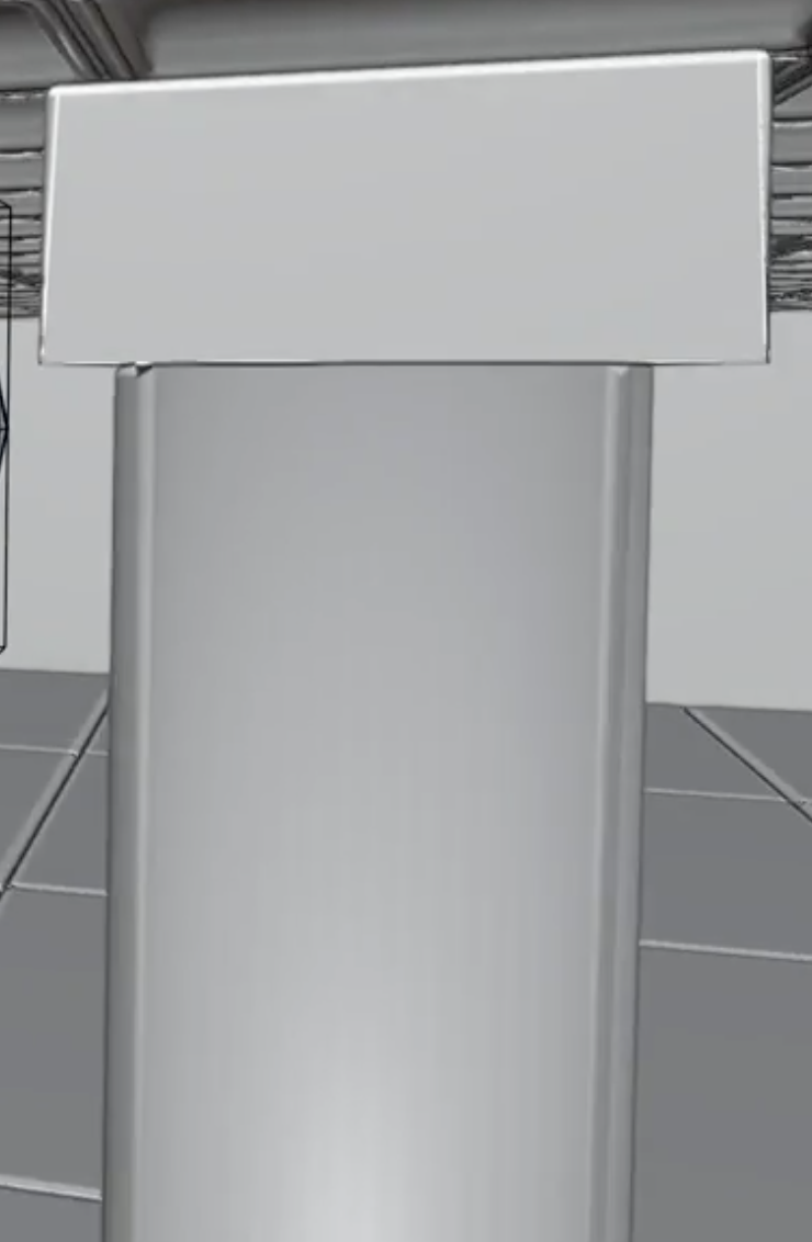

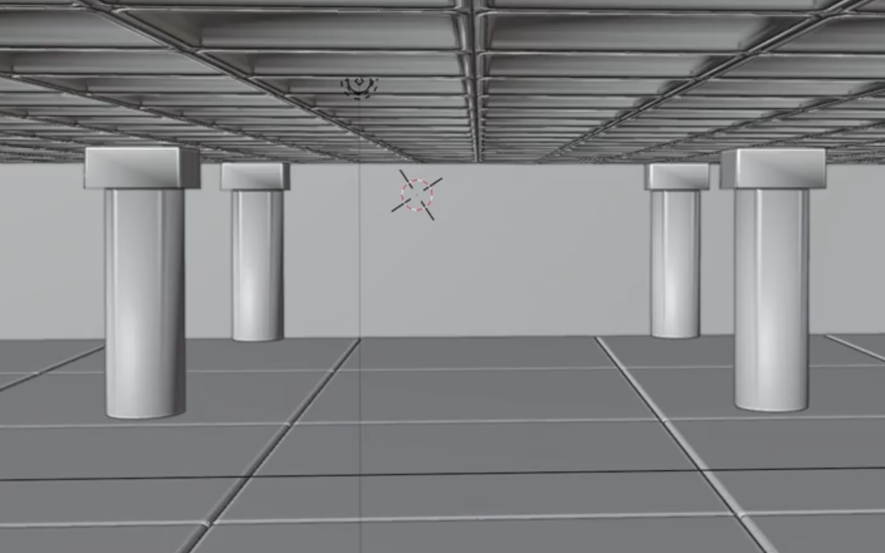

I couldn’t help but notice your columns, they have a problem somewhere, they look like they have some weird extrusion or rogue vertices, unless that’s by design?
