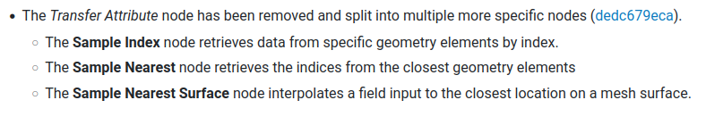

        Yes indeed Samawi,
        It has been replaced by three other Nodes:
        I highly recommend that you read this Article:  https://blog.cgcookie.com/everything-new-in-blender-3-4/

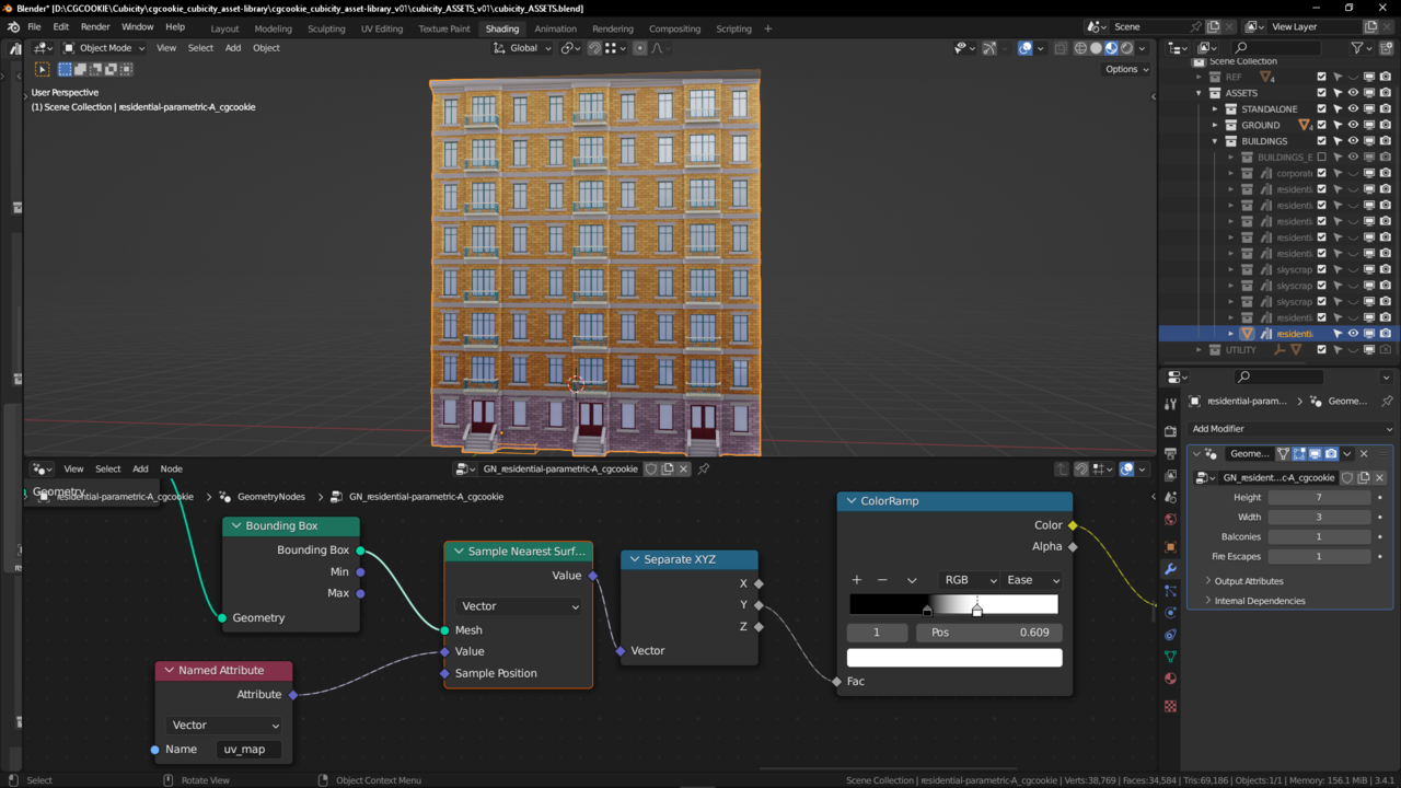

                  Adrian Bellworthy
                    Nice find @maclaud,
                    @theluthier, when opening the original .blend in v3.4, the Transfer Attribute node is replaced with a Sample Nearest Surface node, and everything seems to work as expected.
