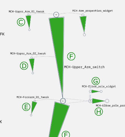

      I might be half asleep (it’s currently 2:02 AM over here) and not seeing it, but the MCH-arm_properties_widget bone appears in green but doesn’t have a constraint box attached to it. I watched all three arm videos back to back and started working following the document after that. I think I got everything working as intended, except my properties bone scales when I take my IK bone far apart :/

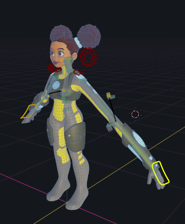

          Thanks for your answer! I think everything’s ok for the most part, but I think the gear shouldn’t scale with the IK bone. Looking around, I figured it’s only this missing constraints on the document for the widget

            Like I said… It  took me two or three times to get it working. I’m not sure what I messed up the first time around, but I did get it working using the schematic he provided.

              What does your constraints look like?

                Yeah there might be a error on the document, but it should be the same as the legs.  Your legs are working correctly yes?
                I will have a proper look tomorrow when I’m back at work but I think you want to parent the widget bone to the properties bone, and have the widget bone damp track to the MCH-Forearm_switch.
                But just check the legs, the answer is there.
                Hope that helps – but I’ll take a proper look tomorrow.

                    I corrected the doc.  The arrow should be showing that the parent of the widget bone is parented to the Arm Properties.
                    The actual final rig is/was already correct.
                    You should be able to see v04 of the schematics in the course file downloads.
                    Hope this hasn’t been too much of a hassle for you, and thanks for pointing out my error.

                        Is that why I had so much trouble with the arm? 😀  I remember going bone by bone not just through the schematic but also comparing to the example rig… I must have figured out something along the way and just not realized that was wrong in the schematic 😀

                          It’s something that I fixed a while ago, but I missed the arrow when I updated the doc.
                          So the finished rig was correct, but the schematic was incorrect.
                          Sorry about that.  My bad.
                          It is very difficult to put all these things together and it’s very prone to human error.  I am certainly human.
